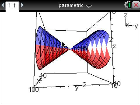

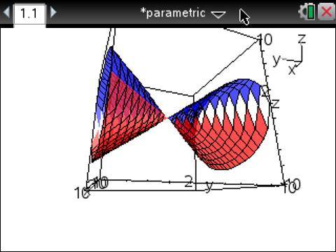

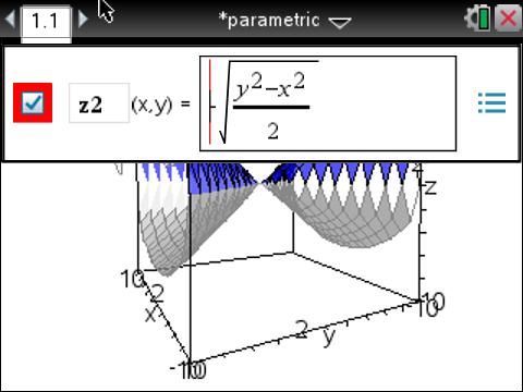

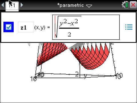

thanks ILS but its not that simple. you see this equations that I am dealing with are squared so i have to solve it in terms of z and with the square root and everything it make the graph totally incomplete and messed up. is there any way to get the full 3d graph?
(ill show you what i mean in a sec)

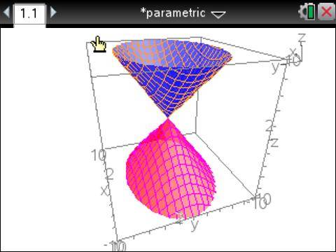

ok so this is the graph of #26 (its in the 2nd pic i think). i have to solve and put them in separately. is there any way to put it all in at one shot? to get a COMPLETE graph.
You'll get a better picture with:
$$z1(x,y)=\sqrt{x^2+2y^2}$$
$$z2(x,y)=-\sqrt{x^2+2y^2}$$
(Smile)
But I'm afraid that when all coordinates are squared, you can't do it in one shot. (Worried)
Anyway, the ones that have an unsquared coordinate can be done in one shot.

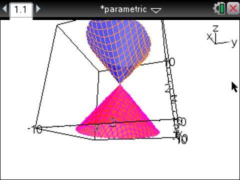

it looks perfect!...but its not the same graph... (:D i would put it on auto rotation for you ILS but its only a screen capture so i can't (Giggle))
View attachment 3224View attachment 3225
- - - Updated (Malthe) - - -
you did intend for it to be the graph of another equation, right (Wondering)?
Yeah. It's rotated with respect to the axes.
So you'll have to rotate your screen to get a proper view. (Doh)
Hmm... that doesn't really matter if you only want to recognize the shape, does it? (Wink)
you did intend for it to be the graph of another equation, right ?
It's the same graph - just rotated. (Emo)
just to be safe though. i don't want to mess up on the test. and how will i know how to change the equation so it comes out looking like a pretty one?
If one of the coordinates is not squared, then reorder the coordinates (switch them around) to make the non-squared one the z-coordinate.
For instance: rearrange $x=y^2+4z^2$ to $z=x^2+4y^2$.
The graph will remain the same, just rotated.If all of them are squared, you will have to introduce a square root.
Pick the z-coordinate as the one that at least gives a square root of something that is always positive. That is, make sure you take the square root of the sum of 2 squares.

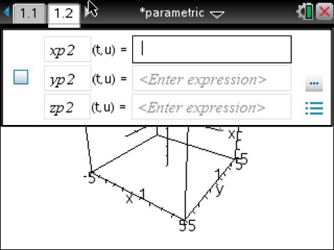

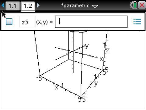

i have a question! i have a question! i have a question!
is there any way to convert the equation into a parametric equation? that's way easier to graph.
You are already converting the equations to parametric equations.
The problem is that your TI Nspyre is limited to parametric equations of the form $z=f(x,y)$. (Swearing)
Wolfram|Alpha doesn't have such limitations. (Muscle)

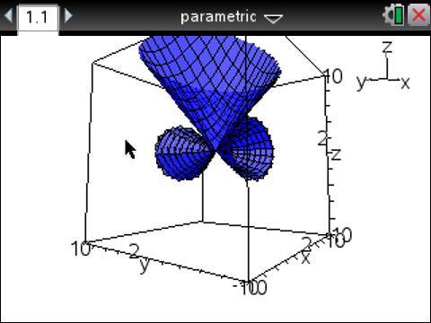

no these graphs i posted are in function form. i can do it in parametric.
Oh.
Well...
Then I think you can graph $y^2=x^2+2z^2$ in one shot with:
$$xp(t,u)=t\cos(u)$$
$$yp(t,u)=t$$
$$zp(t,u)=\frac {t} {\sqrt 2} \sin(u)$$
i literally just burst out laughing when i graphed that.
ignoring the big fat thing in the middle, is the graph represented by the two cones?
Yes. (Wink)
I recognize it by the way the cones are built from rings and radial lines.
The big fat thing in the middle is the graph $z(x,y)=\sqrt{x^2+2y^2}$ that is apparently still lying around. :rolleyes:
LOL oh. well when i get rid of that part... i end up with 3/4 of a graph...
