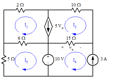

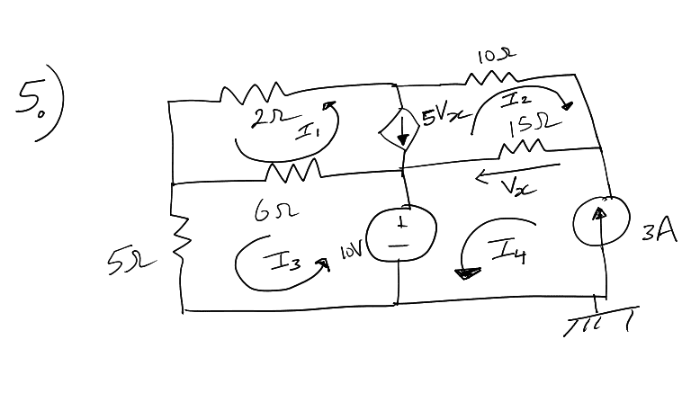

I posted the problem in the picture below.[/B]
Solve for the currents I1,I2,I3,I4
This was my attempt at it using KVL and KCL:
For I1 loop:
8I1-6I3 = -5Vx
For I2 Loop:
5Vx + 15(I2+3) + 10I2 = 0
5Vx+25I2 = -45
For I3 Loop:
-10+6(I3-I1)+5I3 = 0
For I4 Loop
10+15(I2+3) = 0
So from solving this I got I4 as -11/3 A and Vx as -10V from substituting it into 15(I2+3)
But when I substituted these values back into I2 Loop equation I get I2 as 1/5A so I'm getting different values for I2.
Not sure what I'm doing wrong. Is it my equations by chance?
Thanks in advance :D
  • Hand-drawn circuit schematic with four mesh currents labeled I1 to I4, resistors 2 ohm, 6 ohm, 10 ohm, 15 ohm and 5 ohm, a 10 V source, a 3 A current source, and a dependent voltage source of 5Vx with voltage Vx marked.
Sure that should be 15(I2 -I3)?
Also I may be wrong on this, its been a few years since I did questions like this. But since you have a current source of 3A. Isn't I4 3A?
This is an old thread that was left hanging (no final solution to the posed problem). Let's take a stab at solving it, as the solution is unlikely to affect the OP's grades at this point :smile:
For starters, let's use a more conventional assignment of current directions for the meshes (all clockwise):
Circuit schematic with four labeled mesh currents I1 to I4 drawn as clockwise loops; includes 2 Ω, 6 Ω, 5 Ω, 10 Ω and 15 Ω resistors, a dependent current source 5 Vx, a 10 V source, a 3 A current source and voltage Vx across the 15 Ω resistor.
By inspection we can see that ##I_4 = -3## (amps).
That's one loop current solved without hardly any effort. We will need three more equations to solve for the other loop currents.
We can incorporate the influence of the known loop 4 current into the circuit by adding a voltage source to the 15Ω branch (there's no shared resistance with loop 3, so no influence there; The 10 V voltage source is a "wall" beyond which loop 4 cannot have any influence).. The 3 amp mesh current of loop 4 will produce a voltage drop of 3*15 = 45 V across the 15Ω resistor, driving a current counterclockwise in that loop (so the source will have the same polarity as ##v_x## in the diagram). That's the voltage source we need to introduce into that branch to account for ##I_4##. Now we can forget loop 4 and concentrate on the rest of the circuit.
The controlled current source between loops 1 and 2 informs us that we should employ a supermesh. A suitable supermesh would encompass loops 1 and 2. So, writing mesh equations:
Two mesh equations: supermesh loop -I1(2 + 6) - 2(10 + 15) + 45 + I3 6 = 0, and loop 3 -I3(5 + 6) + I1 6 - 10 = 0, with labels Supermesh loop and Loop 3.
We also have to consider the auxiliary, or constraint equations imposed by the controlled current source. So:
Three lines of equations with comments on the right: I1 - I2 = 5·vx for the controlled current source constraint, vx = (I4 - I2)·15 for vx from the loop currents, and vx = (-3 - I2)·15 since I4 is given.

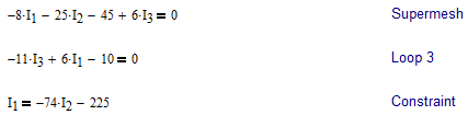

So by the constraint equations we find:
Two linear equations: I1 - I2 = 5[(-3 - I2) · 15] and I1 = -74 · I2 - 225, with currents I1 and I2 in amperes.
If we clean up the equations a bit we now have:
Three mesh analysis equations with labels: Supermesh -8·I1 - 25·I2 - 45 + 6·I3 = 0; Loop 3 -11·I3 + 6·I1 - 10 = 0; Constraint I1 = -74·I2 - 225.
Three equations in three unknowns.
From the three equations we can write the impedance matrix and voltage vector:
Two 3x3 matrices: z has rows (-8, -25, 6), (6, 0, -11), (1, 74, 0); v is a column vector with entries 45, 10, -225.
A person without a computer would likely employ Cramer's Rule or back-substitution or some other method to solve the system of equations. A person with a computer can do the same but without the brain-sweat.
Hence:
Matrix equation: column vector of i1, i2, i3 equals Isolve(z, v), followed by a column vector of i1, i2, i3 equal to 5.823, -3.119, 2.267 with the note all values in amperes.
Translate the current values with our clockwise direction definition to the original circuit diagram's current direction definitions and you're done. Here's the original circuit drawing:
Hand-drawn circuit schematic with four mesh currents I1 to I4, resistors 2Ω, 6Ω, 5Ω, 10Ω and 15Ω, a 5Vx dependent voltage source, a 10V source, a 3A current source, and a labelled Vx.
