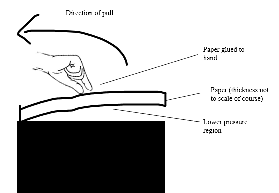

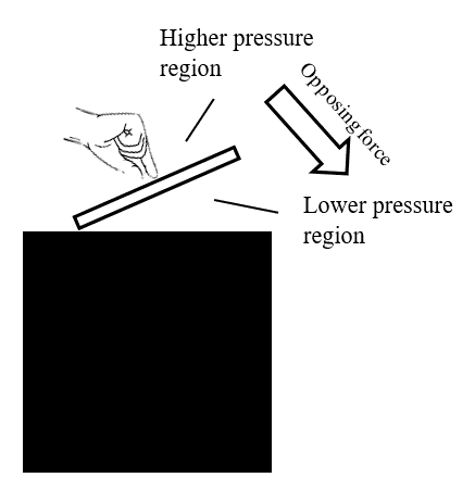

How does a difference in air pressure induce a force? (See picture)
P = F / A, I suppose
Another likely very basic question from me
Suppose I pinch a piece of A4 paper and pull it up, at a velocity of let’s say 1 or 2m/s (i.e. order of magnitude 10^0). The paper, of course, encounters air resistance / drag as it moves through the air, but there’s also a (larger) force that is produced by the pressure difference as, momentarily, the air pressure beneath the paper is lower than above.
1) Are these different forces, or am I just describing the same thing… if not, does the second force have a name? I’ve seen it labelled as ‘drag’, so I’m confused on what actually is what here. Intuitively, they’re different forces, as the mechanism for producing air resistance is not really related to pressure.
2) Am I correct in guessing that the magnitude of air resistance here is much smaller than the force created by the difference in air pressure?
3) The million-euro question - can someone walk me through the mathematical justification for how the second force is produced? More precisely, how does a difference in air pressure across two sides of a body produce a net force? How can it be quantified?
I’m aware that anything to do with the physics of flowing air is a nightmare to model out, but I’m willing to try follow along… (am acquainted with Bernoulli's principal)
Thanks for your time
That’s the easy bit. Pressure exerts a force normal to an adjacent surface. On any small area element of the surface, considered as a vector ##\vec{dA}## normal (into) the surface with a magnitude in proportion to the area, pressure p exerts force ##p\vec {dA}##.
Wrt the pinched paper, I assume you mean it has a crease in the middle making it stand up a little. You pinch at the crease and pull the paper up.
The air pressure will both tend to hold the two pinched sides together and hold the portions still horizontal flat on the table. If the paper were completely limp, there would be no resistance since these forces are normal to the directions of travel.
In reality, some stiffness in the paper will lift it off the table as it approaches the crease. This will lead to a pressure difference on the curved section, creating tension in the paper. That tension will oppose your attempt to lift it.

Lnewqban said:
That is a very rigid piece of paper. :smile:
On what basis do you deduce that?
Lnewqban said:
The net force depends on the pressure differential (P above - P below).
Yes, but not directly, unless the paper is very rigid. As I wrote, it is more likely that the pressure difference results in an increased normal force from the table, in turn resulting in friction.
It was a sarcastic remark based on the shown diagram.
What is represented, seems to behave as a rigid panel.
The link that I then provided follows that idea.
Very accute and valid observation, like usually.
Again, the diagram shows instead a force that is far from normal to the table.
I hope the OP grasps the two very different scenarios and decide on which one to discuss further.
Both are due to collisions with air molecules.
Ah, ok. I hadn't taken that as remotely accurate. In post #2 I suggested a rather different picture and @eddiezhang didn't comment on it either way.
Fair enough - the picture is pretty misleading

I don't think I can edit my original post, so here's a more accurate version of what I'm describing

Is this an aerodynamic drag problem?
This is sort of why I'm asking this question, but are there two distinct forces acting here, i.e. drag / air resistance and then the force induced by the pressure difference (which I will call the 'pressure differential force' from now on)? Or, as I suspect, am I just describing how air resistance / drag is created (i.e. via the pressure difference)? If these two forces are distinct, however, would I be correct in my estimation that the drag force is much less significant than the 'pressure differential force'?
(I'm vaguely aware of there being a difference being 'form drag' and 'pressure drag')
eddiezhang said:
the mathematics of this 'suction' force, assuming certain parameters like the speed at which the newspaper is lifted up (i.e. the resultant velocity of the ruler), the surrounding air pressure, the angle swept out by the ruler, the rigidity of the paper etc.
The ruler case is a bit different from the pinched fingers case.
In the latter, the air pressure difference acts on the paper that's flat on the table, increasing the frictional force. If the surfaces are very smooth, and the paper quite flimsy, you would not feel much resistance. You could try this with cling film, comparing a dry smooth surface with an oiled one.
In the former, the above may still be significant, but now you have a substantial cavity under the paper. Much of the torque needed is in fighting the air pressure above the ruler. Air has to flow in under the paper to fill that cavity, making this case partly an aerodynamic drag problem. Drag slows the inflow, so the air pressure inside the cavity drops.
You have to assume some initial air gap for the flow to start. The size of that will significantly affect the result. As the cavity grows, it will also widen at the base, reducing the drag. Also, each equal rise of ##\Delta\theta## of the ruler does not increase the volume of the cavity by as great a fraction as at first, so the pressure drop is less.
Compare a smooth surface with a rough one (a larger initial channel for the air).

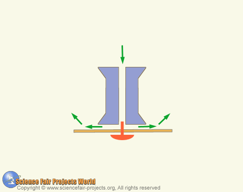

As the air rushes in from the edges of the plate/board/paper toward the central area, its velocity depresses the value of the static pressure under the paper.
That is a brief condition: as the inter-surfaces gap increases, the air velocity decreases and the static pressure increases (not in the case of the ruler under paper experiment, in which the gap remains small).
The following diagrams show an experiment in which the airflow goes in the opposite direction (from center to edges), also creating a suction effect based on Bernoulli’s.
