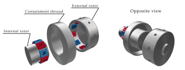

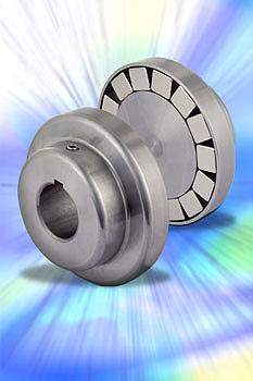

You're correct, a magnetic coupling transmits torque by using magnets on both sides of some pressure boundary.
The magnets can either be set up around a cylinder:
Or around a flat disk:
Obviously there is a non-magnetic pressure boundary that will be placed between the two. The distance between the magnets will dictate how much torque you can transmit for any given application but if you're only transmitting through a wall that has a differential pressure of one atmosphere, you won't have any problems. I've seen them used in applications where the pressure is many hundreds of psi.
You can purchase them off the shelf so I wouldn't try and design your own. Just do a search on magnetic couplings and you'll find all sorts of suppliers.
