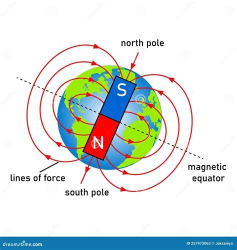

To add to what has already been said, it's as if the earth contains a magnet like this:
From https://www.dreamstime.com/diagram-...field-earth-showing-north-pole-image257473063

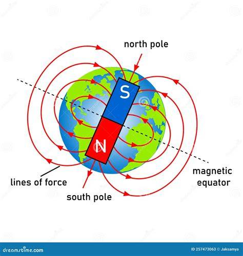

To complete the picture, one must add that a compass needle in a magnetic field aligns so that its "south to north" direction is parallel to the arrow representing the local magnetic field of the Earth. This explains why compasses point (generally) towards the north geographic pole in the northern hemisphere and away from it in the southern hemisphere.
Look at the figure in post #4. Imagine two people with compass needles at the north and south poles. The two needles point in the same direction relative to the Earth. Just by looking at the needle, what direction would each person conclude is "north"?
