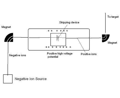

I have a source producing ions of He: He2+ and He+, they are accelerated towards a tandem accelerator, se atteched figure. They are accelerated with a voltage towards the first magnet, were a selection of the ions are made. We only want the He2+ ions the proceed to the tandem accelerator.
Show how this is done in the first analysis magnet.

And the attachemt is here too.
  • Diagram of a tandem accelerator: a negative ion source feeds negative ions through a bending magnet, into a chamber with a stripping device at a positive high voltage potential, then positive ions pass through a second magnet toward a target.
