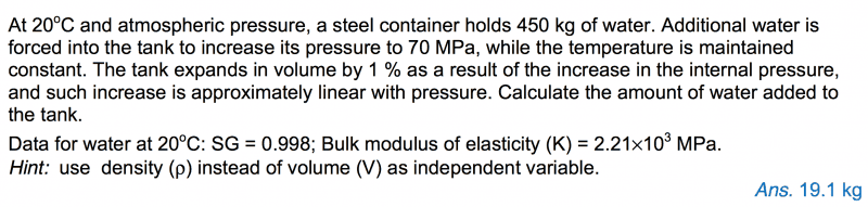

Hey all, I am having trouble getting to the answer of the attached file below. It would be appreciated if anyone had some tips on getting to the answer.
  • Text problem on water compression in a steel tank at 20°C, with data SG = 0.998, bulk modulus K = 2.21×10^3 MPa, a hint to use density, and answer 19.1 kg.
Please tell us your thinking on this problem, and what you have done so far. You said you are having trouble, but we can't help you if we don't know what your trouble is.
Chet
I can't understand what it is that i am supposed to be finding. Everything seems to be given in the question leaving nothing left to be found.
They are asking you how much more water you have to squeeze into the tank to get the pressure up to 70 MPa.
