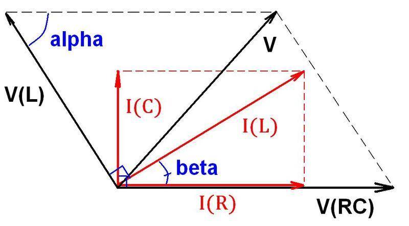

An emf Vosinwt is applied to a circuit which consists of a self inductance L of negligible resistance in series with a variable capacitor C. The capacitor is shunted by a variable resistance R. Find the value of C for which the amplitude of the current independent of R.
We can use Phasor Algebra to make the problem easy. But I don't have any idea how to start.
Shall I take the equation V = jVL + VR ? , which comes out by taking VR along x-axis and VL along Y axis. If we use this equation then there is no capacitance anywhere.
Help me out!

2/ Draw phasor diagram. First draw the V(RC) vector (denoting voltage phasor across C and R). The I(C) vector will be perpendicular to it and leading it by 90 deg. The I(R) vector is in the same direction. Just draw out the vectors with arbitrary length. Then draw I(L) = I(C) + I(R) (vector summation), followed by V(L) and then V = V(L) + V(RC) (again, vector summation!). Playing around with simple geometry, you will get an expression for I(L).

1/ See figure. Try to prove:
_ [tex]V^2 = V_{RC}^2 + V_L^2 - 2V_{RC}V_Lcos\alpha[/tex] (hint: This is purely math. Quite trivial. I think you know this identity :wink:)
_ [tex]cos\alpha = sin\beta[/tex] (hint: again, this is purely math. And again, it's trivial :biggrin:)
The next big step is to deal with big big big expression :biggrin:
2/ You don't have to assume so. We have: VL = IL|XL-XC|, so it can be either way: XL>XC or XL<XC.
  • Phasor diagram of a parallel RLC circuit: black voltage phasors V(L), V(RC) and V with angle alpha between V(L) and V; red current phasors I(R), I(C) and I(L) with angle beta, forming a dashed rectangle.
I think you marked alpha wrong. It should be the angle between VRC and VL.
Alpha and Beta are related by Alpha = 90 + Beta
Next equation is IL2 = IC2 + IR2
Where is the big equation :confused:?
Isn't it the angle between them? :wink: Notice that V(RC) can "move up" to the upper side of the parallelogram that forms V.
After the equation relating V, V(RC), V(L), express V(RC), V(L) and sin(beta) in term of I(L) and impedances.
