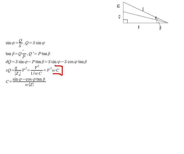

i need to find the equation for the capacitator to lower the imaginary power
Handwritten derivation: sin φ = Q/S, Q = S sin φ; tan β = Q'/P, Q' = P tan β; dQ = S sin φ − P tan β = S sin φ − S cos φ tan β; sQ = q/|Z| V² = V²/(1/ωC) = V² ωC (last term boxed in red); C = (sin φ − cos φ tan β)/(ω|Z|). Beside it is a right triangle with sides dQ, Q, P, hypotenuse S, angles φ and β.
how they got thered marked equation
Are you asking why
[tex]\frac{V^2}{\frac{1}{\omega C}} = V^2 \omega C \text{?}[/tex]
If so, dividing by the reciprocal of a number is the same as multiplying by the number.
