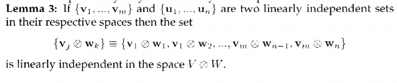

I need help in order to get a clear understanding of an aspect of the proof of Lemma 3 in Section 1.7.3 ...

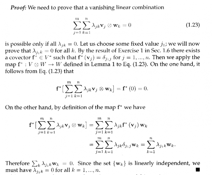

The relevant part of Winitzki's text reads as follows:
In the above quotation from Winitzki we read the following:
" ... ... By the result of Exercise 1 in Sec. 6.3 there exists a covector [itex]f^* \in V^*[/itex] such that
[itex]f^* ( v_j ) = \delta_{ j_1 j }[/itex] for [itex]j = 1, \ ... \ ... \ , \ n[/itex] ... ... "I cannot see how to show that there exists a covector [itex]f^* \in V^*[/itex] such that
[itex]f^* ( v_j ) = \delta_{ j_1 j }[/itex] for [itex]j = 1, \ ... \ ... \ , \ n[/itex] ... ...Can someone help me to show this from first principles ... ?It may be irrelevant to my problem ... but I cannot see the relevance of Exercise 1 in Section 6 which reads as follows:

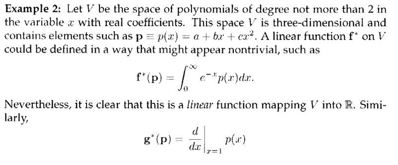

Exercise 1 refers to Example 2 which reads as follows:
BUT ... since I wish to show the result:
... ... ... "there exists a covector [itex]f^* \in V^*[/itex] such that
[itex]f^* ( v_j ) = \delta_{ j_1 j }[/itex] for [itex]j = 1, \ ... \ ... \ , \ n[/itex] ... ..."... from first principles the above example is irrelevant ... BUT then ... I cannot see its relevance anyway!Hope someone can help ... ...

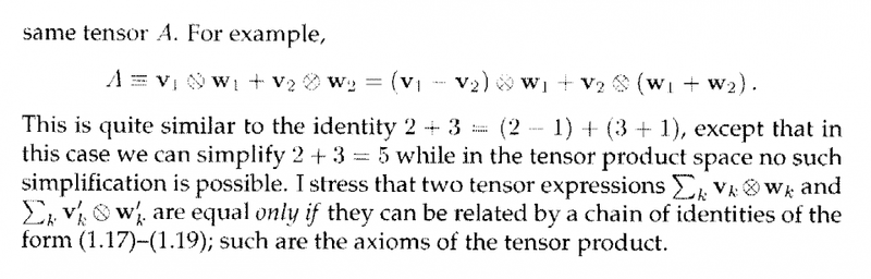

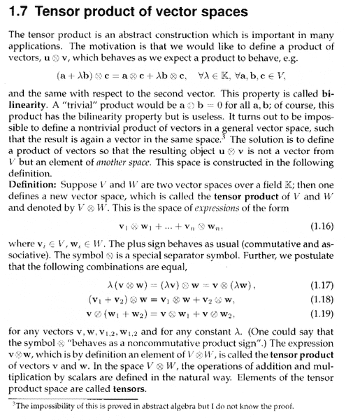

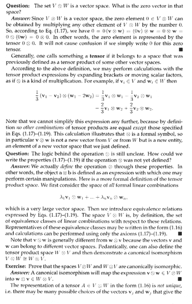

To help readers understand Winitzki's approach and notation for tensors I am providing Winitzki's introduction to Section 1.7 ... ... as follows ... ... :
Read what lavinia explained here:
lavinia said:
If one has a basis ##e_{i}## for the vectors space, then a basis for the vector space of covectors - called the dual basis are the linear maps ##π_{i}## defined by ##π_{i}(e_{j}) = δ_{ij}## This is the covector that assigns 1 to the i'th basis vector and zero to all of the others - as mentioned already above. For each choice of basis ##e_{i}## one has a corresponding choice of basis ##π_{i}## for the vector space of covectors.
The covectors ##v_{i}## mentioned above are the same as the covectors ##π_{i}##. So the function that picks out the i'th coordinate of a vector with respect to a basis is a covector.
Firstly, the author's use of notation is unhelpful, because they are using ##f^*## for two very different maps, one from ##V## to ##\mathbb{R}## and one from ##V\otimes W## to ##\mathbb{R}##. They should use different symbols for the two different maps.
Let's assume ##f^*## refers only to the first map. We show there exists such a map (which is a covector) simply by defining its operation on a set of basis vectors, and then extending it to cover the whole of the domain ##V## using the linearity rules. To be very clear, let's use a different symbol. Given a basis ##B\equiv \{v_1,...,v_n\}## for ##V##, we first define a function ##g^{j_1}:B\to\mathbb{R}## by
$$g^{j_1}(v_k)=\delta_k^{j_1}$$
for ##k\in\{1,...,n\}##.
Then we define ##f^*## to be the linear function from ##V## to ##\mathbb{R}## that agrees with ##g^{j_1}## on ##B##. It is a basic result of linear algebra (no tensors required) that such a function exists and is unique. If you are not comfortable just accepting that fact, a proof should be easy to find in any decent linear algebra text, or it's easy to prove from scratch. The existence follows from the fact that ##\{v_1,...,v_n\}## spans ##V##. To prove uniqueness, assume there are two such extension functions. Then their difference is also a linear function from ##V## to ##\mathbb{R}## and, by looking at its operation on the basis vectors, it's easily seen to be identically zero.

Thanks Samy and Andrew ... appreciate the help ...
Still working through the Lemma ... but I must say Andrew, your point on the notation really changed things for me ... I now have a pretty good understanding regarding what is going on in the proof of Lemma 3 ...
Thanks again,
