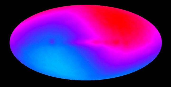

This would fit well with the pattern of the CMB dipole from COBE (see George Smoot astrophysics page where it says: "the COBE DMR observations clearly show the change in velocity at the 30 kilometers per second due to the motion of the Earth around the Sun. One can see a clear sinsusodial pattern in the amplitude and direction of the dipole with a one year period in the four years of COBE DMR data. Differencing maps taken six months apart produces the familar dipole pattern with the amplitude and direction of the Earth's motion."

Well, yes, taking the galaxy motion in the usual idealized sense of the comoving frame (CMB frame, thus my reference to the COBE dipole picture).
