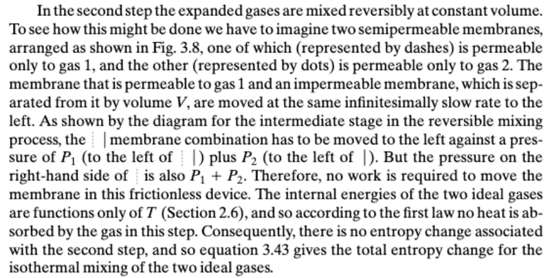

Step 2 (My question is about this step)
The expanded gases are mixed reversibly at constant volume.
Here is a picture of how this is can be done reversibly
The dashed line represents a membrane permeable only to gas 1 and the dotted line represents a membrane permeable only to gas 2.
There is an impermeable membrane separated from the dashed membrane by a volume ##V##.
We move the the dashed line and the solid line to the left at an infinitesimally slow rate.
What happens is that in between the dashed and dotted lines we will have the gas mixture.
Now here is the part I don't quite understand.
The book I am reading says the following
In my own words
The pressure to the left of this membrane combination is ##P_1##.
The pressure between the dotted line and the solid line, where there is only gas 2, is ##P_2##.
The pressure between the dashed line and the dotted line is ##P_1+P_2##.
Why is it that we can say no work is required to move the membranes to the left?
My understanding is the following
We are moving two membranes, the dashed line and the solid line, to the left.
There is a pressure ##P_1## on the dashed membrane and a pressure ##P_2## on the solid membrane.
These represent essentially forces on the membranes (since the membranes have the same area).
Thus, we have to overcome a pressure of ##P_1+P_2##.
On the other hand, there is a pressure of ##P_1+P_2## on the right side of the dashed membrane.
Thus, in terms of pressure on the overall combination of the two membranes being moved, the pressure is zero.
Since the areas are the same, this essentially means we have zero net force on the combination and so no work is done in moving it.
I think this answers my question.
