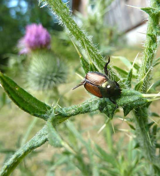

Here's a Panasonic pocket-cam pic of a Japanese beetle. See the raised white dot on the carapace? This beetle is a goner. That's the egg of a parasitic fly, and in a couple of days the wonderful little maggot will burrow into the beetle and start eating it alive. The beetle will drop to the ground and dig into try to get away from the attack, giving the maggot a nice safe place to eat and mature.
