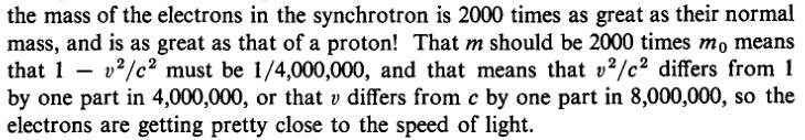

Fast electrons in synchrotron approach the speed of light:
I don't get to the "one part in 8,000,000"
Momentum: ##~P=mv=\frac{m_0v}{\sqrt{1-v^2/c^2}}##
$$\frac{v^2}{c^2}=1-\frac{1}{4E6}~\rightarrow~\frac{v}{c}=\frac{1}{1.000,000,5}$$
$$\rightarrow~v=\frac{c}{1.000,000,5}$$
$$c-v=c\left( 1-\frac{1}{1.000,000,5} \right) \neq c\cdot \frac{1}{8,000,000}$$
1 part in 8 million is 1/8000000. But since it differs from 1 by this much, you have 7,999,999 / 8,000,000

Yes, sorry, the - in the exponent was a typo. Should have been (1-¼10-6)½. And I meant binomial expansion. Other than that...
I am not sure why you need Taylor Series to approximate it. You could do this: let r = (v/c). Then we have (1 - r^2) = (1 + r)(1 - r).
Since v differs from c by 1 part in 8 million, then (1 + r) is approx 2 {since r is approx 1}, and (1 - r) is 1 divided by 8 million. So you have: (1 - r^2) is approx 2/(8 million) = 1/(4 million).
The square root of that is 1/2000. You could run this in reverse, if you know the 2000 and want to determine the 1/(8 million).
I've seen the Taylor polynomial approximation used in quantum mechanics if there's a need to include the relativistic "mass increase" in the form of a lowest order perturbation in the Schrödinger equation, but I'm not sure why that is done here.
This is all based on, for small ##\epsilon##:
##\frac{1}{1 \pm \epsilon} = 1 \mp \epsilon##
And
##(1 + \epsilon)^2 = 1 + 2\epsilon##
In particular, if ##\frac{v}{c} = 1- \epsilon##, then ##\frac{v^2}{c^2} = 1- 2\epsilon## and ##1 - \frac{v^2}{c^2} = 2\epsilon##

The positive solution of ##1/\sqrt{1-\beta^2} = 2000## is ##\beta = \sqrt{3,999,999}/2000##, so ##1 - \beta = 0.1250 \times 10^{-6} = 1/8,000,000.##
Actually, that last should be ##1/7,999,999.500000031250##, approximately

You should notice something that when you see: c - v = 1/(8 E6). On the left side, you have speed (Length/Time), and the right side is dimensionless. So something didn't get put in, correctly. Now with this: c-v = c/(8 E6), both sides have the same dimensions.
c-v = c/(8 E6) has correct dimensions and, as PeroK said, is probably the correct answer but how do you explain "v differs from c by one part in 8,000,000"?
I expected to see c-v=1/8,000,000

Well, you expected wrong. That equation is dimensionally nonsense.
How did you get that?
$$\frac{1}{\sqrt{1-\beta^2}}=2000~\rightarrow~\sqrt{1-\beta^2}=0.0005~\rightarrow~\beta=0.999,999,875$$
Which differs from 1 by one part in 8 million.

Of course, the solution of ##1/\sqrt{1-\beta^2} = \gamma## is ##\beta = \sqrt{1-\gamma^{-2}},## which expands out as
$$\beta = 1 -\frac{1}{2 \gamma^2} -\frac{1}{8 \gamma^4} - \cdots,$$
by applying the series expansion for ##\sqrt{1-x}## for small ##x = 1/\gamma^2.## If you keep only the ##1/\gamma^2## term you get exactly 1 part in 8,000,000 because we are using ##\gamma = 2000.##
What if it said something like v differed from c by 1%, would it be clear that v = 0.99c ?
Instead of 1% they could say v differs from c by 1 part in 100. It means the same thing.
So instead of 1 part in 8million difference, they could say differ by 0.0000125%
