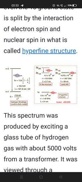

So the orbitals become closer to each other as the principle quantum number increases. What does (1-1/n²) represent exactly? And what's the importance of 1 here?

Yeah. What I'm asking is, isn't the limit of the hydrogen nucleus 1s orbital? And since spin number does not affect energy, then there should be only only one possible energy level of electron that's connected to the nucleus of a hydrogen atom, So to where does the electron jump to, in order to produce emmision absorption spectrum?

  • Diagram of hydrogen energy levels with n=1 and n=2 on the left, showing the 121.6 nm UV transition, and a right panel labelling the 2s and 2p sublevels as 2p1/2, 2p3/2 and 2s1/2 with fine-structure and Lamb shift energies and frequencies, and a 1s hyperfine structure splitting of 5.9 x 10^-6 eV, 1.42 GHz, 21 cm, scaled x50,000.

No, it is not the limit. 1s is where the electron sits if not excited, but when excited it can jump to any other orbital. It is just that in the hydrogen atom always only one orbital is occupied (and actually only in half).

Not exactly, what you asked about in your second post (about these fractions) is where the spin comes into the picture - it is what is called a "hyper-fine structure". Follow the link on the hyperphysics site for more details (basically there is a tiny interaction between nucleus spin and electron spin).
