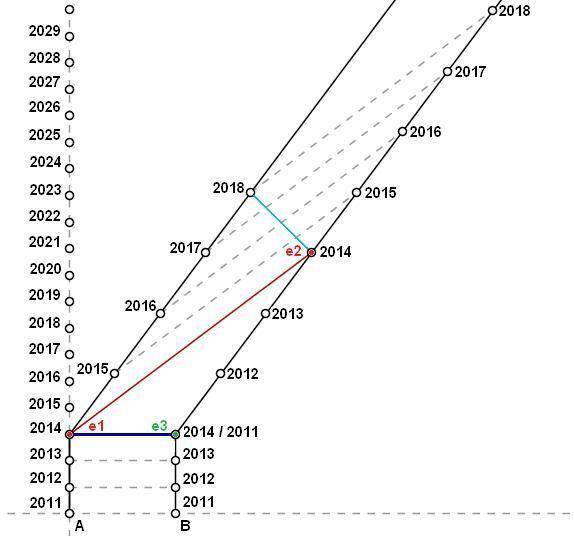

I have created this diagram to help illustrate some of the concepts that are being discussed here:
https://www.physicsforums.com/attachment.php?attachmentid=67593&stc=1&d=1394744076
A and B are initially at rest in frame S in the year 2014. The line of simultaneity is represented by the horizontal blue line connecting A and B at events e1 and e3. By prior agreement they both instantaneously accelerate to high speed to the right simultaneously in 2014 as measured in S. The line of simultaneity is now represented by the tilted red line connecting events e1 and e2 in the new rest frame of A and B.
By a naive interpretation, from A's point of view in A's new reference frame, B has shot into the future of frame S and is "now" (by A's new definition of now) in the year 2021 of the old reference frame S. However it is not as straight forward as that simple interpretation suggests. When an extended objects accelerates to a new reference frame the clocks do not automatically synchronise themselves. B had to wind his clock back by 3 years at the acceleration event (e3) so that his clock would be re-synchronised with A in the new reference frame. B had to wait a further 3 years of his own proper time to arrive at the event (e2) that A called "now" when A accelerated in 2014. There was no magical leap into the future as far as B was concerned and B had to manually adjust his clock. While A assumes that B was at event e2 immediately after the acceleration event, A does not see where B actually was, until the light from that event (the light blue line) arrives back at A in the year 2018 of the new reference frame or the year 2023 in the old reference frame and anything could have happened to B in the intervening years to prove A was wrong in his assumption of where B was in his new concept of "now" in the year 2014.
In the year 2018 of the new reference frame, A can look back and have real information about the events e1, e2 and e3 as they are all in his past light cone and can now say with some objectivity that B was at event e2 when A started accelerating at event e1 in the year 2014, but from the point of view of his new reference frame, B started accelerated to the new reference frame, 3 years earlier than A. This is a perfectly valid interpretation of past events, but at no time does A or B have information about the future before it happens beyond an educated guess. To me, the unpleasant aspect of the spacetime loaf concept, (which I believe is closely related to the block universe idea), is that it implies the future is predetermined.
