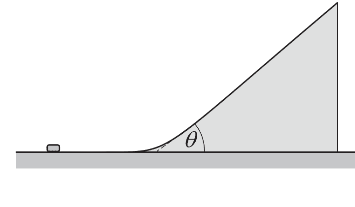

A wedge is placed on a frictionless floor and it is free to move. Its inclination is θ with the horizontal everywhere except at the bottom, where it increases gradually from a vanishingly small value to θ in a very small region (See fig 1). Then, a small disc whose mass is the same as the wedge's is projected towards the wedge with an initial velocity u.
Assuming transit time of the disc on the curved entry to be negligible , find displacement of the wedge when the disc is at the highest point on the wedge!
Assume that every surface is frictionless.
Momentum conservation
Newton's law
So, when the mass reached the peak, its horizontal velocity will be the same as the wedge's. Using conservation of momentum :
$$ mu = 2mv$$
$$v = \frac u 2$$
With v is the final velocity for both objects.
Now, what we need is the acceleration of the wedge, which we can find by using Newton's law.
$$a = \frac { g sin\theta cos\theta} {sin² \theta +1}$$ ( I looked this up on a book to make sure that I don't make a mistake)
Lastly, all I need to do is to find the distance that the wedge has moved. I can use this : $$s = \frac {v²-0²} {2a}$$ So, the answer is
$$s = \frac {u² (sin² \theta +1)} {8g sin\theta cos\theta}$$
strangely, according to the book, the answer is wrong.
Why?

Personally, I get a similar answer as you. I applied Newton’s Laws in the non-inertial frame of the wedge yielding three useful equations of motion. You find that ##a_w## does not depend on the velocity of the puck but depends on the slope of the wedge (as you have indicated). So, if the wedge is not initially moving, the kinematic relationship applies to the wedge. I think that is your issue. I believe that factor of “8”should be a “2”, and not ##u## in the denominator but ##v_f##.
When the disc suddenly changes its direction of motion at the bottom of the wedge, it suddenly loses some horizontal momentum. But horizontal momentum overall must be conserved. Thus, the wedge suddenly gains momentum. So, the wedge does not have zero velocity when it starts its constant acceleration of
##\large \frac{g \sin \theta \cos \theta}{1+\sin^2 \theta}##. The disc essentially gives an impulse to the wedge as it mounts the wedge.

During the small transit time, the disc exerts a large, impulsive force on the wedge. So, the wedge has a nonzero, initial velocity by the time the disc is "fully on" the wedge (with the disc still essentially at the bottom of the wedge). I derived expressions for the initial velocity of the wedge and the displacement of the wedge when the disc is at max height. It was a little tedious, so I certainly could have made errors.
@Rikudo Can you give us the book's answer for the displacement of the wedge?
I thought assuming the transit time to be “negligible” means the impulse during the transition is to be ignored ## \Delta t \ll 1 ##.
erobz said:
I thought assuming the transit time to be “negligible” means the impulse is to be ignored
The impulse cannot be ignored. We essentially have a collision between the disc and the wedge as the direction of travel of the disc suddenly changes.

$$\frac {u²} {8gsin\theta} (2\sqrt {1+sin²\theta} - cos\theta)$$
Way off! I guess let’s see what @TSny has to offer.
That's what I got. For the initial speed of the wedge at the beginning of the constant acceleration I find $$v_0 = \frac{u}{2}\left(1-\frac{\cos \theta}{\sqrt{1+\sin^2\theta}} \right)$$

Any hints for how to get to this result? I would think the momentum of the puck has to change magnitude of velocity and direction, but how do we know the extent of the change in both these?
Here's an outline of a solution where most of the analysis is carried out in the center of mass reference frame (CMF).
(1) In the CMF, what are the speeds of the wedge and the disc before the disc encounters the wedge? Express in terms of ##u##, the initial speed of the disc in the lab frame.
Each has speed ##u/2##.
(2) What is the system's total energy in the CMF?
##E = \large \frac{mu^2}{4}##
(3) What is the maximum vertical height ##y_{max}## attained by the disc?
##y_{max} = \large \frac{u^2}{4g}##
(4) Let ##v_x## denote the magnitude of the horizontal velocity of the disc (or wedge) in the CMF at some instant while the disc is sliding up the wedge. Let ##v_y## denote the corresponding vertical speed of the disc. Express ##v_y## in terms of ##v_x## and ##\theta##.
##v_y = 2 v_x \tan \theta##
(5) Let ##v_{x,0}## and ##v_{y,0}## denote the horizontal and vertical components of the velocity of the disc in the CMF just after the disc starts sliding up the wedge. Use conservation of energy and the result of (4) to find expressions for ##v_{x,0}## and ##v_{y,0}## in terms of ##u## and ##\theta##.
##\large v_{x,0} = \frac{u}{2} \frac{\cos \theta}{\sqrt{1+\sin^2 \theta}} \,\,\,\,\,\, v_{y, 0} = u \frac{\sin \theta}{\sqrt{1+\sin^2 \theta}}##
(6)The time interval ##\Delta t## that it takes the disc to reach maximum height is just ##\Delta t = \large \frac{y_{max}}{\langle v_y \rangle}##, where ##\langle v_y \rangle## is the average vertical velocity of the disc. Find ##\Delta t## in terms of ##u##, ##g##, and ##\theta##.
##\Delta t= \large \frac{u}{2g} \frac {\sqrt{1+\sin^2 \theta}}{\sin \theta}##
(7) The displacement ##\Delta x_{cm}## of the wedge in the CMF while the disc slides up the wedge is ##\Delta x_{cm} = \langle v_{x} \rangle \Delta t##. Find ##\Delta x_{cm}## in terms of ##u, g## and ##\theta##.
##\Delta x_{cm} = \left(-\frac{v_{x,0}}{2} \right) \Delta t = \large -\frac{u^2 \cot \theta}{8g }##
(8) Find the displacement ##\Delta x_{lab}## of the wedge in the lab frame.
##\Delta x_{lab} = \Delta x_{cm} + \frac{u}{2} \Delta t = \large \frac{u^2 \left ( 2 \sqrt{1+\sin^2 \theta} - \cos \theta \right )}{8g \sin \theta} ##
