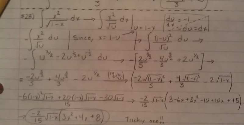

[tex]\int \frac{x^{2}}{\sqrt(1-x)}dx[/tex]
I let [itex]u=\sqrt(1-x)[/itex], and [itex]dx = \frac{2\sqrt(1-x)du}{-1}[/itex]
So I came to this guy here:
[tex]\int \frac{2x^{2}\sqrt(1-x)}{-u}du[/tex]
But now if I resubstitute the [itex]\sqrt(1-x)[/itex] back in for u to cancel, I am still stuck with that x, and du at the end.

It's easier not to work with the square roots:
IF [itex]u=\sqrt{1-x}[/itex], then [itex]u^2=1-x[/itex], thus [itex]2udu=-dx[/itex].
Furthermore, [itex]x=1-u^2[/itex], thus [itex]x^2=(1-u^2)^2[/itex].
Now you can substitute everything in the integral.

Okay, I am giving this problem a shot now:
[tex]\int \frac{x^{2}}{\sqrt{1-x}}dx[/tex]
[tex]u=\sqrt{1-x}[/tex]
[tex]u^{2}=1-x[/tex]
[tex]x=1-u^{2}[/tex]
[tex]\frac{du}{dx}=\frac{-1}{2\sqrt{1-x}}[/tex]
Since [itex]\sqrt{1-x} = u[/itex], then
[tex]\frac{du}{dx}=\frac{-1}{2u}[/tex]
[tex]dx = -2udu[/tex]
and so here is the squiggly guy:
[tex]\int \frac{-2ux^{2}}{u}du[/tex]
and since [itex]x=1-u^{2}[/itex]
[itex]x^{2}=1-2u^{2}+u^{4}[/itex]
and so, putting all that back into the integrand:
[tex]\int \frac{-2u(1-2u^{2}+u^{4})}{u}du[/tex]
Pair of u's cancel out
[tex]\int -2(1-2u^{2}+u^{4})du[/tex]
[tex]\int -2+4u^{2}-2u^{4}du[/tex]
Which is something that I can integrate easily...
[tex]-2u+\frac{4u^{3}}{3}-\frac{4u^{5}}{5}[/tex]
To which, back go my original u's to get...
[tex]-2(\sqrt{1-x})+\frac{4(\sqrt{1-x})^{3}}{3}-\frac{4(\sqrt{1-x})^{5}}{5} + C[/tex]
Which is a nightmare to simplify, that can't be right?
I'd leave it as it. You can differentiate it and see if you recover the integrand.
I found a much, much, much easier way to do this while playing around a bit. I'm too tired to latex it, but this one is correct as far as I can tell. The other answer might be right too, I didn't finish simplifying it.
The rest of my courses problems have definite integrals, and we have not covered that yet at all.
Again, thanks for all the help!
