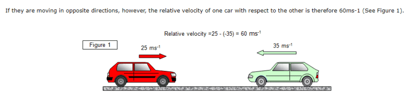

Sorry I don't understand why we are subtracting the velocities? Don't they add up when the two bodies are moving in opposite direction relative to each other?

Hamza Abbasi said:
Sorry I don't understand why we are subtracting the velocities? Don't they add up when the two bodies are moving in opposite direction relative to each other?View attachment 224607
That is subtraction. It's ##25m/s - (-35m/s) = 60 m/s##.
I think you are confused by speeds and velocities. In this case, you subtract the negative velocity, which is the same as adding the speeds.
PS If you given general velocities, like ##v_1, v_2## you really need to have them pointing in the same direction in any diagram. If you are given specific velocities, like ##+25m/s, -35m/s## then you can show them in opposite directions.
Okay !
I think I get it.
The velocity v2 already include negative sign and magnitude in it ? I don't need to put an extra negative sign in it ,Right?

##v_2## is unspecified. You might infer from the problem that ##v_1 > 0## and ##v_2 < 0##, but it doesn't actually say that. It doesn't even say they are traveling in opposite directions. You could assume that ##v_1 > 0## and ##v_2 < 0##, but the forumula for relative velocity is still ##v_1 - v_2##.
To do what you want to do, you would have to assume that ##v_1 > 0## and ##v_2 = -u##, where ##u > 0##. Then, the velocity of A relative to B would be ##v_1 - v_2 = v_1 + u##.
But, really you should be thinking that in general ##v_1, v_2## can both be positive or negative.
In fact, even if you take ##v_1 = v_2##, then the answer given in the book is still correct. It's irrelevant, in other words, whether they ever pass by each other. That condition could, in fact, be omitted from the question.
