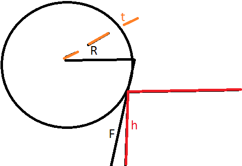

This is the image I have came out with.
From this picture I can conclude that
τ = Frsinθ
The known values are:
F = 410
I know that Force of gravity is pushing down and the torque for wheel pushing upward. Hence,
mgR/2 = FRsinθ
(mg)/(2F) = sinθ
Is the approach correct? because I could not find the fraction for it
I don't think you have to worry about torque here. Just find the normal force upward as it depends on how high the step is and set it equal to the weight.

F is applied horizontally.
Which angle is theta? Is it what I suggested?
How did you get mgR/2?

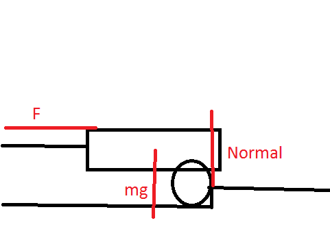

Can I suggest a slightly different diagram. I would also look at the torques about the point where the wheel meets the step.

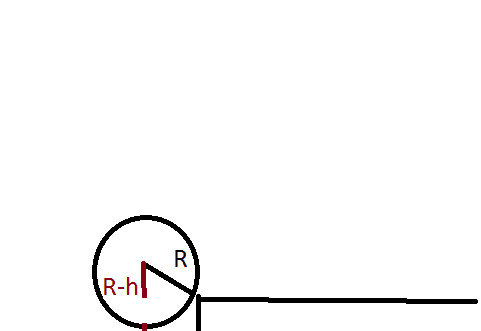

Haruspex,
I have decided to remove my thought on torque and drew the body diagram again.
sin θ = (R-h)/R
θ = 1-h/R
θ = 1-n
Is this what you are suggesting?
So according to your diagram
tanθ=Mg/2F
The torque where the points meet. The formula for torque is
τ=Frsinθ

I think you mean sin θ = 1 - n.
The new diagram is better, but you have the normal wrong. When a point contacts a smooth surface, the normal is the normal to the surface, in this case the wheel. Correct that, then write out the horizontal and vertical statics equations.

I was thinking that to rotate about the point of contact with the step there must be a net clockwise torque.
Clockwise you have F(rSinθ)
Anticlockwise you have 0.5mg(rcosθ)
The brackets are just to highlight the distance term.
The factor of 0.5 comes from the fact that roughly half the weight is supported by the wheel on one end and half by the man on the handles at the other. I guess it depends what the expression "uniformly distributed" means but I reckon this is a reasonable approximation.
So I think the condition to climb the step is..
FrSinθ - 0.5mgrcosθ > 0
Edit: I'm happy to be convinced that another approach is better !
It says the force is horizontal. I think you have to take that literally or there's not enough information to answer the question. Of course, when pushing a wheelbarrow on the flat the person has to take some of the vertical load, but typically the handles are long enough that the wheel takes most of it. When trying to get up the step, there's no longer a need for the person to apply any vertical force. It can be purely horizontal now.
