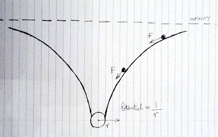

The link between field strength and potential also occurs in gravitation, which in some ways is easier to grasp because we only ever seem (need) to deal with point sources.
In gravitation I use the sketch I have attached to 'show' that force = gradient (steepness) of the potential graph.
The Earth can be thought of as sitting at the bottom of a potential well with potential increasing along the curve as distance from the Earth increases (This is the 1/r curve)
If you see the potential curve as the sides of a valley then I hope that it is easy to picture the force down the valley has something to do with the steepness of the valley sides.
The steepness is of the form d/dr which will give the 1/r^2 equation for force.
The same analogy goes for point electric charges.
The electric field between parallel charged plates is uniform so the graph of potential against distance across the plates is a straight line... constant steepness... which means that the force on a charge between parallel plates is constant.
Hope this helps and matches up with what you know.
