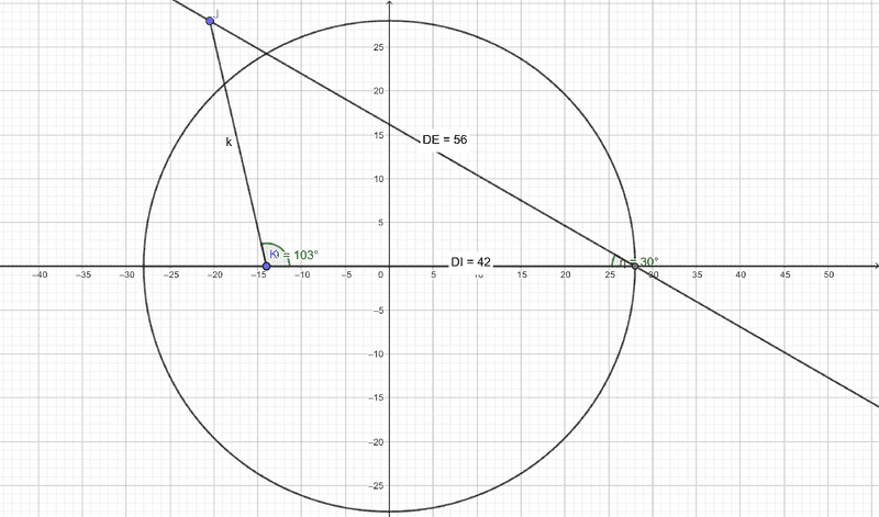

1) $$b^2=a^2+c^2-2ac\cos{(\theta)}=826.336\Rightarrow{b=\sqrt{826.336}}=28.746$$
2) $$\cfrac{28.74}{\sin{(30^o)}}=\cfrac{56}{\sin{(x)}}\Rightarrow{x=77}$$

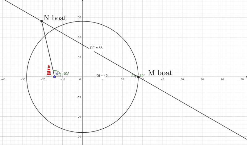

As shown at the Geogebra file, the angle is ##103^o##
Also, where is the guiding light at the sketch drawn?

Your equation looks good, but there are two solutions for ##x##. ##\sin(77)=sin(103)##.
You should also check on @jedishrfu 's comment.

The plot you showed isn't very helpful, as it doesn't label the points where the ships are or where the lighthouse is (headlamp is a small light that you can wear on your head) or which angle is which. The Spanish equivalent of "lighthouse" is "faro." "Head lamp" is "lampara frontal.
Also, what does "the angle formed in M" mean? 30° relative to what?
In answer to your summary, the thing about the sine function is that both an angle and its supplement have the same sine value. IOW, ##\sin(\theta) = \sin(180° - \theta)## so using the Law of Sines can sometimes give misleading results if you aren't working from a reasonable drawing.

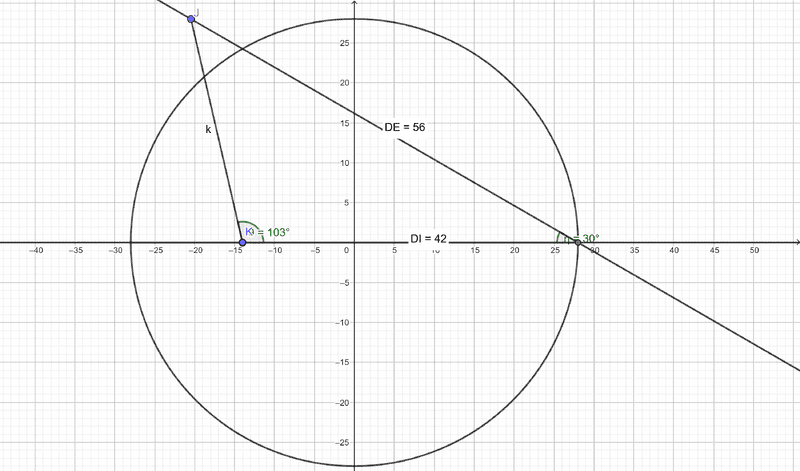

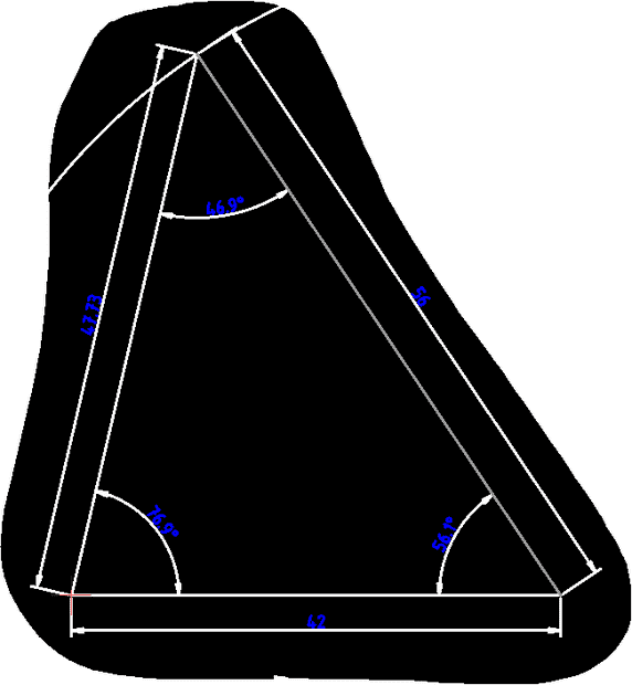

Some well rated translators misleaded me.
Relative to...:frown: Lighthouse is on the left side of this late sketch.
##\sin{77^o}=\sin{180^o-77^o}## Why the second one? The exercise is got not frame of reference, since it is static (lighthouse should be, but ships don't move); this is, I choose ##M## boat, because this way everything fits.
When your equation has multiple solutions, you have to see which solutions fit the original problem.
What is unreasonable about the drawing though? It looks like every application that I've ever seen. I was unaware that it could do this.
There are no indications of where the two ships are, where the lighthouse is, angle measures, or side lengths. I suppose one might take some time to reason where all these things are, but I didn't feel like taking that time.
I didn't like that none of the labels matched the description or the equation. In fact, no labels in the description, equation, or diagram match any other. I didn't even try to figure it out. It's not my job.

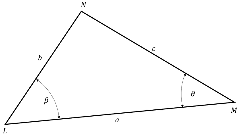

The Law of Cosines applied twice gives the correct solution if you take the positive root for the distance between the lighthouse to the ship at ##N##. Which is consistent with the definition of distance. It gives the false solution of 77° if you say the distance is ##- \sqrt{~~~}##.
I vote to demote the Law of Sines to a "soft rule". :smile:
With the Law of Cosines we find that:
$$ b^2 = a^2 + c^2 - 2 a c \cos \theta $$
$$ \implies b = \sqrt{a^2 + c^2 - 2 a c \cos \theta} $$
Now apply again:
$$ c^2 = a^2 + b^2 - 2 a b \cos \beta $$
$$ \implies \cos \beta = \frac{b^2 + a^2 - c^2}{2ab} $$
Substitute in for ##b^2## , and ##b##:
$$ \implies \cos \beta = \frac{ [a^2 \cancel{+ c^2} - 2 a c \cos \theta]+ a^2 \cancel{- c^2}}{2a\sqrt{a^2 + c^2 - 2 a c \cos \theta}} $$
$$ \cos \beta = \frac{ 2a^2 - 2 a c \cos \theta }{2a \sqrt{a^2 + c^2 - 2 a c \cos \theta} } $$
$$ \cos \beta = \frac{\cancel{2a}( a- c \cos \theta) }{\cancel{2a} \sqrt{a^2 + c^2 - 2 a c \cos \theta} } $$
$$ \boxed{ \beta = \arccos \left( \frac{ a- c \cos \theta }{ \sqrt{a^2 + c^2 - 2 a c \cos \theta} } \right) } \tag{General Solution}$$
for ## a = 42, c= 56, \theta = 30^{\circ}##
$$ \beta = \arccos \left( \frac{ 42- 56 \cos 30^{\circ} }{ \sqrt{42^2 + 56^2 - 2 \cdot 42\cdot 56 \cos 30^{\circ}} } \right) \approx 103^{\circ} $$
A single correct solution...

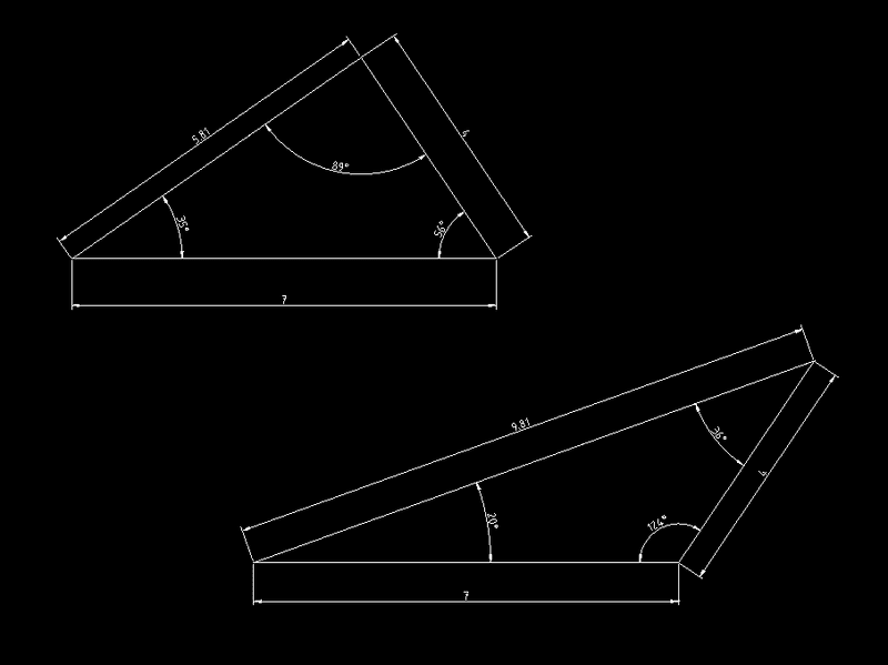

If you're given an angle and the two sides adjacent to it, you can always use the Law of Cosines to find the other angles and sides of a triangle. However, if you are given an angle and two sides, with one of the sides adjacent to the angle and the other opposite the angle, there are two possible triangles that can be formed.
In the drawing below you're given angle B and sides a and b of the two triangles. If you use the Law of Sines to find angle A, you will need to choose whether the acute angle (as in the triangle on the right) or the obtuse angle (as in the triangle on the left) is the appropriate solution. This is why having a drawing with the sides and angles labeled is important.
