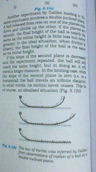

In case of Newtons 1st law, Look at this, it's Galileo's observations,
Textbook page with three diagrams of a ball rolling on inclined planes: a ball on a dashed-line track rising toward the initial height, a shallower curve, and a nearly flat track with a dashed line. Caption reads: The law of inertia was inferred by Galileo from observations of motion of a ball on a double inclined plane.
so there isn't much mathematical proof in this case.
Hope this was helpful.
