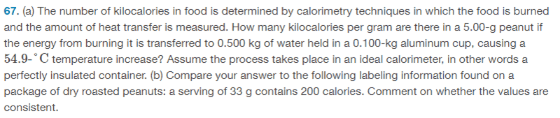

How many kilocalories per gram are there in a 5.00-g peanut?

The discussion revolves around calculating the kilocalories per gram in a 5.00-g peanut using calorimetry principles. Participants are examining the heat exchange in a calorimeter setup involving the burning of peanuts and the subsequent temperature change in water and an aluminum container.
  • The original poster attempts to apply the principle of conservation of energy in their calculations but questions the method used in part (a) of the problem. Other participants clarify the role of the calorimeter and the components involved in heat measurement.
Participants are actively engaging in clarifying misunderstandings about the calorimeter's setup and the assumptions made in the calculations. Some guidance has been provided regarding the inclusion of the aluminum container in the heat calculations, but no consensus has been reached on the original poster's method.
There appears to be confusion regarding the ideal nature of the calorimeter and the components involved in the heat transfer process. The original poster's method may not align with the expected approach due to this misunderstanding.

However, I am not sure why they did part(a) like that. I thought we would do it like this:
##Q_{nut} + Q_{w} = 0## since calorimeter is ideal so energy is conserved in the nut-water system
##Q_{nut} =-Q_{w}##
##Q_{nut} = -(0.500)(4184)(54.9) = -1.15 \times 10^5 J##
Therefore, the heat lost by the nut is ##Q_{nut} = 1.15 \times 10^5 J = 27.45 \frac{kcal}{5.00g} = 5.49 \frac{kcal}{g}##
However, I don't understand their method for part(a), is there a mistake in mine?Many thanks!
I think you misunderstood the measurement. For part (a) you generate heat ##Q## by burning 5 g of peanuts. The peanut at this point is gone but the heat is not. The heat is used to raise the temperature of two things, the water and the aluminum container which together form the calorimeter. It is these two that are assumed isolated from the rest of the world so that the heat ##Q## that is pumped into them goes into raising their common temperature by 54.9 °C. You misunderstood in what way the calorimeter is "ideal."

That is very helpful. I did not realize that the calorimeter included the aluminum container, so using my method I should have done ##Q_{nut} + Q_{w} + Q_{A1} = 0##
