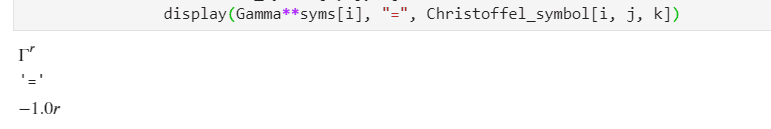

I have a code that is something like this
Code:
print("Gamma^",syms[i],"_",syms[j],syms[k], "=", syms[1], syms[2]**2)
When I print in jupyter-lab it looks like this
Code:
Gamma^ r _ theta theta = r theta**2
Gamma^ r _ phi phi = r theta**2
Gamma^ theta _ r theta = r theta**2
Gamma^ theta _ theta r = r theta**2
Gamma^ theta _ phi phi = r theta**2
Gamma^ phi _ r phi = r theta**2
Gamma^ phi _ theta phi = r theta**2
Gamma^ phi _ phi r = r theta**2
Gamma^ phi _ phi theta = r theta**2
Is there a way to make it something like this
$$\Gamma^{\phi}_{\phi \theta} = r\theta^2$$
or very similar at least

display works a bit but not much. First the major problem is that I cannot put both subcripts such as $$\Gamma^{r}_{\theta r}$$
etc.
Second each comma moves it to the next line but ıf I remove the comma the code gives an error.

Do some string manipulation. For example,
Python:
from IPython.display import Latex, display
display(Latex('$\Gamma^{{{0:s}}}{{}}_{{{1:s} {2:s}}}$'.format('r','\\theta','r')))
produces [itex]\Gamma^r_{\theta r}[/itex] if run in a jupyer workbook cell.
It's unfortunate that {} has a syntactic meaning for python's String.format function, so if you want a literal brace in the argument passed to Latex you need to enter a double brace in the string on which you invoke format.
You can obtain the latex code of a sympy expression by passing it to sympy.latex.

It says
Code:
TypeError: unsupported format string passed to Symbol.__format__
I think I have been able to reproduce that, together with two solutions:
Python:
>>> from sympy import Symbol, latex
>>> "{0:s}".format(Symbol('\\theta'))
Traceback (most recent call last):
  File "<pyshell#39>", line 1, in <module>
>>> "{0}".format(Symbol('\\theta'))
'\\theta'
>>> "{0:s}".format(latex(Symbol('\\theta')))
'\\theta'
So I would try
Python:
display(Latex('$\\Gamma^{{{0}}}{{}}_{{{1} {2}}} = {3}$'.format(
syms[i], syms[j], syms[k], Christoffel_symbol[i,j,k]
I have upgraded your solution. This works just as I have wanted.
Code:
display(Latex('$\\Gamma^{{{0}}}{{}}_{{{1}{2}}} = {3}$'.format(latex(syms[i]), latex(syms[j]), latex(syms[k]), latex(Christoffel_symbol[i,j,k]))))
Thanks for the help. I really appreciate it
