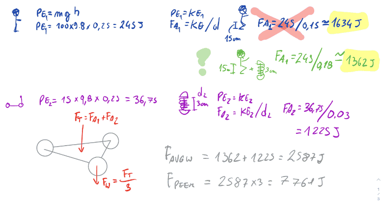

So I did some research and found that I could calculate the Force of that fall using the following:
F = m.g.h
m = scoter mass + user mass = 115kg
g = 9,81m/s
h=0,25m
F = 282 Kgf
I understand that this is very simplistic and its probably the F upon reaching to the ground and nothing to do with the rest of the crash process.
My scooter has shocks and rubber to absorb 3cms (I have no idea how to dimension the strength of the shocks as as to resist the impact of r even to travel around besides the Mass divided by the 3 points of road contact.
And the person on that impact is not rigid on top of the scooter and can bend his/her Knees 15cm to absorb the shock.
And I know it can get a lot more dense, but I really don’t know what to pursuit and learn to Understand what are the maximum forced distributed to structure or even (another entirely different discipline probably.

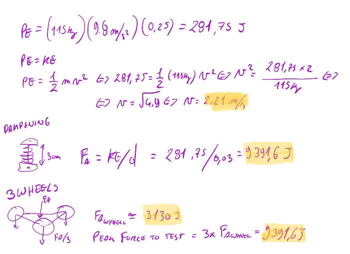

In one dimension, impact forces are most easily estimated using the concept of stopping distance.
If the kinetic energy at impact is KE, the average force, F, over a stopping distance of d is:
F = KE/d.
Clearly, reducing the impact force usually means increasing the stopping distance. Springs or cushioned pads or inflated tires are some common approaches.
Of course, injuries and mechanical failures (stuff breaks) are more related to the peak force in the interaction rather than the average. But having studied this in many cases, it is rare for the peak force to be more than two or three times the average force when an impact brings an object to rest.
Decreasing the average stopping force by increasing the stopping distance is usually much easier than decreasing the peak to average ratio of the stopping force.

So if after getting the average force*2 or *3 would be a good starting point to dimension parts before road testing?
I would suggest lab testing prototype designs before road testing. But average force *3 will be a good estimate of peak force, as long as the system does not "bottom out". Once a spring or tire or pad is fully compressed, the system has "bottomed out" and there can be a much larger spike in the peak force.

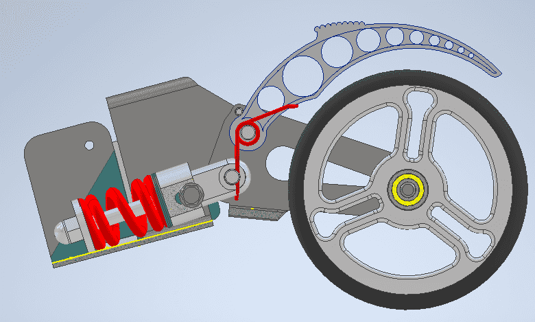

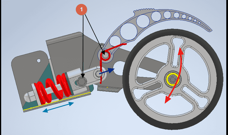

CAD render of a scooter rear suspension: a red coil spring on a horizontal shock, a swing arm to a wheel with three spokes, and a red-outlined lever linkage to a toothed arc.
Back dampening was built like that.

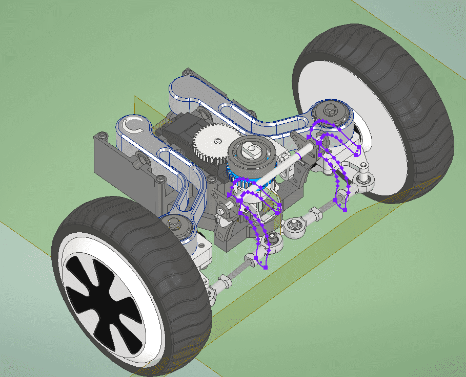

The front is a bit more messie, I still had no money to prototype nothing from new version just digital model.
CAD render of a three-wheeled scooter chassis with front suspension arms, steering linkage, a large gear and a horizontally mounted shock on the rear, with two wheels visible.

Tiago Carita said:
CAD rendering of a rear wheel and swingarm suspension linkage with a coil spring and damper unit mounted on a small frame.

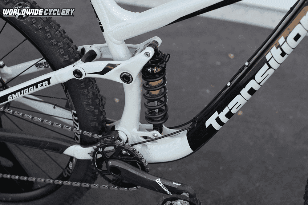

That orientation looks incorrect to me (I could be wrong). It looks like you are wanting to use a compression spring and damper in tension mode, which I don't think will work. Shouldn't the compression spring and damper be coupled to the upper arm, with the bottom arm constrained just with a pivot?
Like typical MTB rear suspension...
https://cdn.shopify.com/s/files/1/0...oil-Cane-Creek-Coil-Close-Up.png?v=1542311444
Close-up of a white full-suspension mountain bike rear end with a black coil spring and damper unit linking the swingarm to the frame, with 'Transition' and 'Smuggler' printed on the frame.
  • CAD render of a bicycle-style rear suspension linkage: a grey mounting bracket with a spring-and-damper unit, a large wheel with spokes, and red pivot or mounting parts.
Maybe the drawing is not clear ... (1) represents the axis that are fixed.
This suspention is the smalest i could find on market and work a bit diferent, not sure the name but insted of compressing you expand the connection nd the end rod compresses the spring
CAD render of a spring-loaded mechanism with a red coil spring on a sliding rod, a rotating arm with pivot points labelled 1, a blue double-headed arrow showing sliding motion, and a grey wheel with red rotation arrow.

A spring suspension system is one way to get a reasonably smooth ride and minimize impact forces.
Another way is rigidly mount the wheels on a flexible platform, similar to a skateboard with a flexible board. The flexible board could be spring steel, aluminum alloy, or fiberglass composite. All of those are available in sheets that can be sawed to size, and drilled for attachments. A composite board allows you to design for high torsional stiffness and low bending stiffness, or vice versa, if it improves your design. Another possibility is a fiber reinforced injection molded plastic board.
You would need to design the battery mounting so that board flexing would not be transmitted to the battery or its mounting.
Oh, I see it now. The upward motion of the wheel pulls on the center rod (pulls on the far end of the rod), which does result in spring compression. Thanks, I've never seen that before. :smile:
berkeman said:
Oh, I see it now. The upward motion of the wheel pulls on the center rod (pulls on the far end of the rod), which ndoes result in spring compression. Thanks, I've never seen that before. :smile:
That way i can place the shock at the bottom of the frame and get a litle bit of space on top for things...

Gathering some of the information I reached to this average peak force if no bottoming out occurs.
I’ve assumed that the wheels rubber and springs compress 3cms and that since I have 3 contact points, I could divide the peek force by 3 and apply individually in each.
Then I will use this force to dimension the parts before any test.
Handwritten calculations: potential energy PE = (115 kg)(9.8 m/s²)(0.25) = 281.75 J, then PE = KE giving v = 2.21 m/s; damping PA = KE/d = 281.75/0.03 = 9391.6 J; three wheels sketch, peak force to test = 3 x 9391.6 J.
But I Believe that this only applies if the Man is rigid.
Should I separate the Mans weight and let's say it will bend its knees 15cms and after calculating the average Force convert to Kgf and then calculate the scooter part using its mass plus the average force of the man?
After thinking a bit and trying out some things I got to this.
Handwritten physics working on a whiteboard-style sketch: energy and spring force calculations for a person falling and bending knees 15 cm, a scooter wheel spring compressed 3 cm, a triangle diagram of three wheels with total force FT, and averaged peak force values of 2587 J and 7761 J.
So I assumed the man would ben 15cms at the knees, and after consideration added the scooter 3cms of springs and rubber and calculated it alone
Then calculated the scooter alone and added the forces.
I really hope I ate least progressed in the right direction.
Thank you.
TC
Probably not a rigorous assumption, since it is equivalent to the idea that all the wheels landing at the same time (or close enough). When wheeled vehicles land after a fall, it is rare for all the wheels to land at the same time, or nearly at the same time so that the load is evenly distributed on the wheels and suspensions through the landing process.
It's not a horrible assumption to surmise that the rider bending their knees will reduce the peak loading, but without empirical data on the timing and magnitude of the biomechanical response, one risks making an overly optimistic assessment. Also consider that when estimating failure loading, you need to use a "worst case" rather than a "typical" or "average" contribution from the rider. A 15 cm knee bending is probably more optimistic than the worst case and may be more optimistic than the typical, depending on the riders.
True its more probable to hit with the front wheels and not at the same time. I thought dimensioning the parts would be simpler...
I have a knee injury because I’ve not bent my knees on an accident, o I should know better.
To be closer to reality I should assume then the rigidity of the rider and that we probably land on one wheel and the peek impact will be there.
That is really a huge amount of stress...
