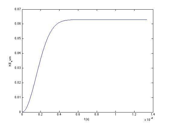

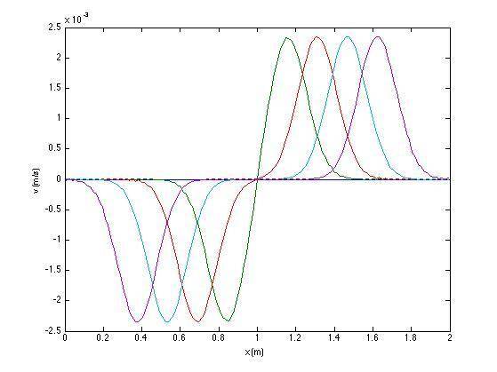

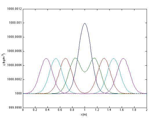

Hi, so I've added my density, velocity, K.E (against space) and sum of K.E at nodes (agains time) plot, before the wave reaches the boundary so that the results are independent of the type of BC choses. The sum of KE's tend to increase at the starts as velocity is zero at the start, I wonder if internal energy is present? Am I missing something here? Thanks!

Line plot of KE_um against t(s), with the x-axis scaled by 10^-4, showing the curve rising from zero to about 0.063 and then levelling off flat for the rest of the time range.
Plot of density rho (kg/m^3) against x (m) from 0 to 2, showing a narrow peak near x = 1 of about 1000.001 over a baseline of 1000, with smaller pulses of about 1000.0005 spread on either side at successive positions.
Line plot of v (m/s) against x (m) from 0 to 2 showing a pulse that splits into a negative left-moving and positive right-moving wave at several successive times; the x-axis is scaled by 10^-3 on the y-axis.
Right. I should have said this earlier. It is the total energy that is conserved, so you need to include the internal energy. The internal energy will be decreasing as your initial fluid pulse expands. Do you know how to calculate the internal energy? If so, you should add this to the KE and plot the total energy.

Hi, thanks again. Not quite sure, I think by integrating du = -p dv which I am guessing will give u - u_0 = -p (v-v_0), but not quite sure what the specific volume will be. I am guessing that's where density comes in.
