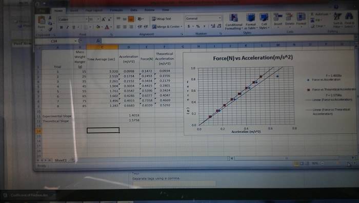

I had to a lab on the Newton's second law of motion, and one of the direction was to "determine the force of friction" from a graph I constructed. The experiment is similar to this: http://people.sc.fsu.edu/~dduke/manual/gp1.htm
This image of the data is a lot cleaner than my representation of it.
Data:
Trial Mass Weight Hanger (g) Time Average (sec) Acceleration (m/s^2) Force(N) Theoretical Acceleration (m/s^2)
1 15 3.320 0.0998 0.1472 0.0934
2 25 2.519 0.1734 0.2453 0.1556
3 35 2.261 0.2152 0.3434 0.2179
4 45 1.904 0.3034 0.4415 0.2801
5 55 1.761 0.3547 0.5396 0.3424
6 65 1.602 0.4286 0.6377 0.4047
7 75 1.496 0.4915 0.7358 0.4669
8 85 1.283 0.6683 0.8339 0.5292
Experimental Slope 1.4018
Theoretical Slope 1.5758
Total mass of system 1.5758 kg
F = uN = umg ( But we weren't given a coefficient of friction, so I wonder if calculating frictional force is even possible)
Fk = -F (Fk = kinetic force of friction)
I think you would subtract 1.5758 - 1.4018 to get the difference in kg, and then multiply that by an acceleration of 1 to get the coefficient of friction 0.174. Then I guess you multiply that by the 1.5758 to get the force of friction 0.2742 N.

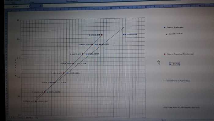

and I did; I suspected that something was fishy there, too. My equation of the experimental without "the force" was y = 1.2729x + 0.056 and the theoretical was the same as before, y = 1.5758x.
This was my normal graph:
Ok. Well, we still need to see the connection between Fapplied = ma + Ffriction and y = mx + b. What does the force of friction correspond to in the equation y = mx + b?
the y-intercept
Good. So, you should be able to get the friction force from your graph if you don't force the graph to go through the origin.
Why wouldn't the experimental acceleration line go through the origin though? I thought an acceleration of zero corresponds to a force of zero. Or is that what corresponds to the force of friction? Also to determine the percent error of the graph, what value x would I subtract from the theoretical value over the theoretical. ((x-1.5758)/1.5758). The addition of the y-intercept to the equation confuses me. And I presume the force of friction is just +0.0556?

Zero acceleration corresponds to zero net force. So, when the acceleration is zero, what would be the applied force (when friction is present)?
net force + the friction force = 0.0566 applied force
Go back to basics for a moment. If Fapplied - Ffriction = ma, then what would be the value of the applied force when you have zero acceleration? (It will not be zero.) Keep in mind that you are graphing only the applied force, not the net force. So, do you see why your graph should not go through the origin when friction is present?
Ah, because fapplied would be = ffriction at zero acceleration. So then would the 0.0556 friction be negative because it is acting against the force of the cart?
The friction force would act in the negative direction, but the applied force (which is what you're plotting) would be positive. Thus, to make the cart move at constant velocity (zero acceleration) the applied force would have to be a positive force that balances out the negative friction force. So, the applied force at zero acceleration should be positive.
Note that when we write Fapplied - Ffriction = ma, then the symbol Ffriction represents the magnitude of the force of friction. That is, Ffriction represents a positive number. We take into account the negative direction of the friction force with the minus sign in Fapplied - Ffriction.
And to calculate percentage error I would do: (1.2729 - 1.5758)/ 1.5758, or ((slope experimental - slope theoretical)/ slope theoretical) without considering the force of friction?
Thank you for all the help.
Right. You should note that friction does not affect the slope of the graph, only the y-intercept.
