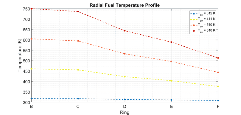

I'm using Serpent and the assumption of @rpp about the procedure is correct. For what concern temperature profiles I'm using an exact proportionality with power in each ring of the core (labeled as "B" "C" "D" ...).
Line graph titled Radial Fuel Temperature Profile: temperature in K against ring B to F for four average temperatures (312, 411, 510, 610 K), each curve falling from B to F.
Initial and final T. profiles are taken starting from power distribution and then fixing the desired average temperature. The minimum temperature variation is in the outer ring and it's about 20 degrees, the average temperature variation is around 50 degrees at each step.

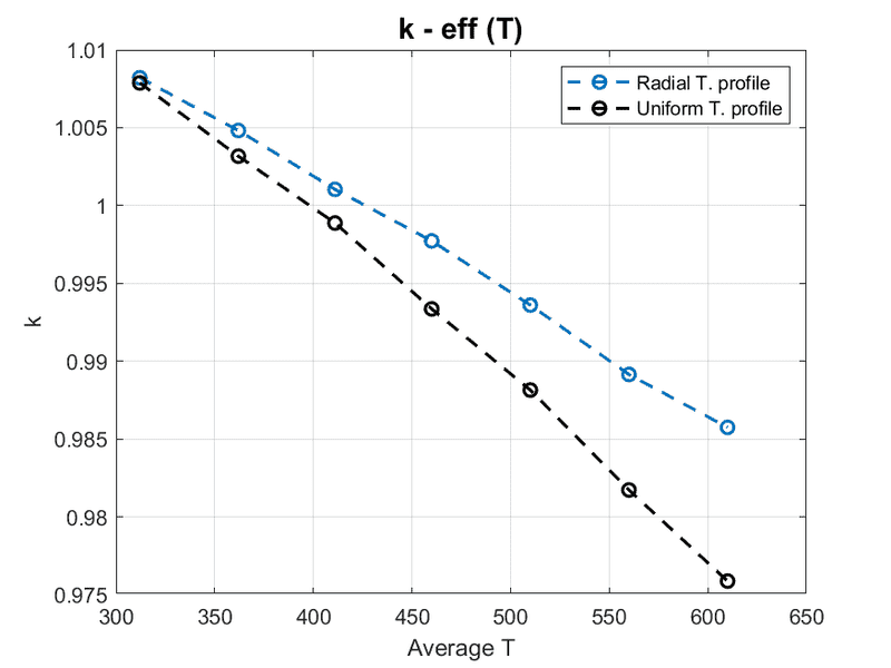

The uncertainty on k-eff is around +-0.00015. Below you can see the effect of temperature on k.
Line plot titled k - eff (T) of k against Average T from 300 to 650 K, with two dashed curves: Radial T. profile (blue) and Uniform T. profile (black), both decreasing as temperature rises, the uniform curve falling faster.
The effect is quite big compared to the uncertanty, so i would say that is not a matter of uncertainty or convergence, what's your opinion?Thanks @Alex A for the document. I tried to do something similar to your suggestion, i evaluated the total amount of fission and absorpion in each region of the core. It seems that in the outer region the difference (#Fission-#Capture) is higher than in the inner region, i tried also to compute an effective temperature using as weight this difference. The result is an effective temperature which is smaller than the average one (580K against 610K) but in my opinion it is not sufficient (Feedback coef. at an average T of 580 K is again much higher).
