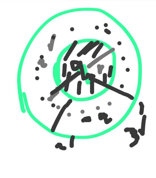

i seem to be bad at phrasing and latex as well i hope this makes my approach clear,
The gaussian sphere i used has a radius of 2r from the center seems to enclose just the small sphere while the -q is on the shell so i assumed when substituting in the equation it is not enclosed
$$\oint Eda= E4\pi(2r)^2=q enclosed /\epsilon$$
I moved everything to the right and let E on one side and thus got whats supposed too bee the electric field
Then I started doubting this approach and thinking maybe -q is actually enclosed too by the spherical shape i used

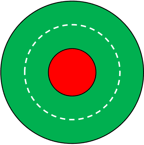

Here is a drawing. Positive charge is red of radius r, negative charge is green of radius 3r. The Gaussian surface at 2r is represented by the dashed white line.

I see i should really have drawn a better drawing i totally forgot about -q being from r to 2r thank you so much i will try again

This says that the entire green volume in post #10 contains charge -q.

True i was fixated on the drawing i drew to simplify the question and since -q was written near the line of the gaussian shape i considered it from 2r to 3r and started debating if it is inside the spherical shape that has 2r as radius or is it on the outer part ,
I think i will try to draw a gaussing shape that has radius r and fill it with -q and a gaussian shape with 2r and -q and substract the smaller one from the bigger one so that the amount of q i have is just between r and 2r , will update after taking a small break
