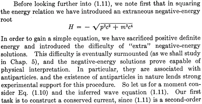

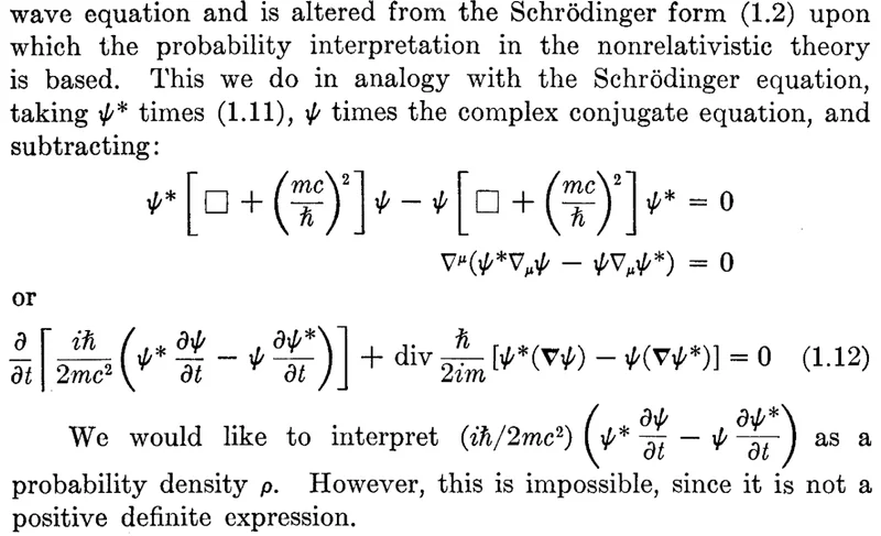

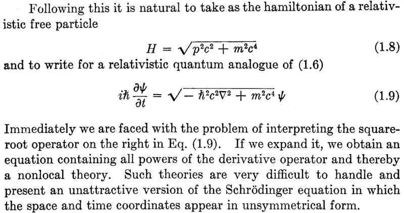

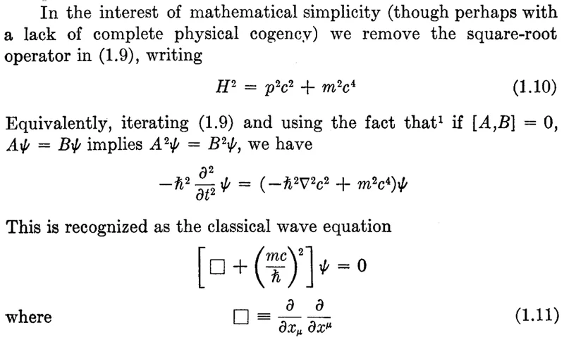

mad mathematician said:
Can you provide a calculation that shows this claim?
The following is taken from Bjorken and Drell, Relativistic Quantum Mechanics (1964), pp. 5-6:
So the problem with the Klein-Gordon equation is not that its "probability" four-current ##\left(i\hslash/2mc^{2}\right)\left(\psi^{\ast}\partial_{\mu}\psi-\psi\partial_{\mu}\psi^{\ast}\right)## fails to be conserved, but rather that its time-like component ##\left(i\hslash/2mc^{2}\right)\left(\psi^{\ast}\partial\psi/\partial t-\psi\partial\psi^{\ast}/\partial t\right)## can be negative and therefore cannot be interpreted as a probability-density ##\rho##.
  • Agree
