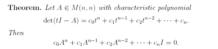

Hello everybody. I have to prove the fallowing theorem:
The Cayley-Hamilton Theorem
Typeset statement of the Cayley-Hamilton theorem: for A in M(n,n) with characteristic polynomial det(tI - A) = c0 t^n + c1 t^(n-1) + ... + cn, then c0 A^n + c1 A^(n-1) + ... + cn I = 0.
help me please...
How far did you get? As far as I can see, it is not as simple as it might appear, will say it takes several steps. What do you know about minimal polynomials and generalized eigenspaces? Have you done a google search? I'm almost sure that the proof can be found online.
What happens if you substitute A for t in the determinant equation?

do you understand my post #6? i.e. in high school algebra we learn the root factor theorem that in particular, if (x-a) divides a polynomial, then x=a is a root of that polynomial. Now the characteristic determinant is a polynomial with matrix coefficients. By essentially the same proof as in high school one can prove that the root ffactor theorem for polynomials with coefficients chiosen from a non commutative ring. The only difference is that since the ring elements do not commute, you must distinguish whether you plug in the element on the left or on the right. I.e. you evaluate from the left by substitutiing for X in X^r.c, and you evaluate from the right by substituting for X in c.X^r. But the same result holds. I.e. X=A is a left root of a polynomial if and only if (X-A) divides the polynomial from the left.
Then use the standard equation above in post #5, oops, it should be rather: [tI-A].adjoint[tI-A] = det[tI-A].I.
then use the fact that this equation between matrices with polynomial entries holds also as an equation between polynomials with matrix entries.
Thus the linear factor [tI-A] divides the characteristic polynomial det[tI-A] from the left, as a polynomial with matrix enries. Hence setting t = A gives a left root of the characteristic polynomial. This proof requires understanding some non - commutative algebra, but it is the simplest most direct proof since it shows that if you understand what is being said, then the standard equation immediately gives the proof. In particular the nature of the field is irrelevant.
