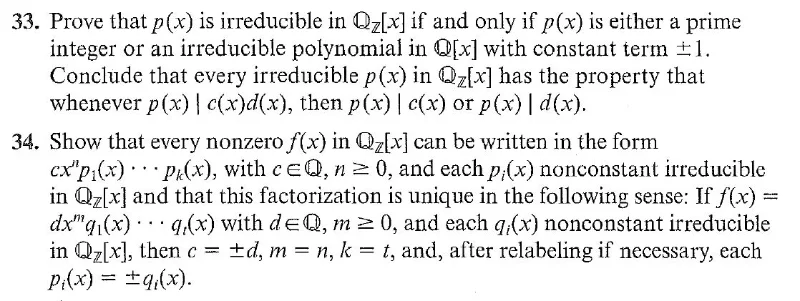

elias001
390
30
Background
Notation: ##\Bbb{Q}_{\Bbb{Z}}[x]=\Bbb{Z}+x\Bbb{Q}[x]##
Assumed exercises:
(1)(a) Prove that the only units in ##\Bbb{Q}_{\Bbb{Z}}[x]## are ##1## and ##-1##.
(b) If ##f(x)\in \Bbb{Q}_{\Bbb{Z}}[x]##, show that the only associates are ##f(x)## and ##-f(x)##.
(2)(a) If ##p## is prime in ##\Bbb{Z}##, prove that the constant polynomial ##p## is irreducible in ##\Bbb{Q}_{\Bbb{Z}}[x]##.
(b) If ##p## and ##q## are positive primes in ##\Bbb{Z}## with ##p\neq q##, prove that ##p## and ##q## are not associates in ##\Bbb{Q}_{\Bbb{Z}}[x]##.
(3)(a) Show that the only divisors of ##x## in ##\Bbb{Q}_{\Bbb{Z}}[x]## are the integers (constant polynomials) and first-degree polynomials
of the form ##\frac{1}{n}x## with ##0\neq n\in \Bbb{Z}##.
(b) For each nonzero ##n\in \Bbb{Z}##, show that the polynomial ##\frac{1}{n}x## is not irreducible in ##\Bbb{Q}_{\Bbb{Z}}[x]##.
(c) Show that ##x## cannot be written as a finite product of irreducible elements in ##\Bbb{Q}_{\Bbb{Z}}[x]##.
Exercise: Prove that ##p(x)## is irreducible in ##\Bbb{Q}_{\Bbb{Z}}[x]## if and only if ##p(x)## is either a prime integer or an irreducible polynomial in ##\Bbb{Q}[x]## with constant term ##\pm 1##.
Question:
If I already proved the assumed exercises ##(1)## to ##(3)## above and I want to show one direction for the Exercise above:
##p(x)## is irreducible in ##\Bbb{Q}_{\Bbb{Z}}[x]## implies ##p(x)## is an irreducible polynomial in ##\Bbb{Q}[x]## with constant term
##\pm 1##
I am not clear on how to show: if an irreducible polynomial
##p(x)\in\Bbb{Q}[x]## is of the form ##p(x)=g(x)x\pm 1,## where ##g(x)\in \Bbb{Q}[x],## then ##p(x)## is irreducible in ##\Bbb{Q}_{\Bbb{Z}}[x]##.
Thank you in advance

If ##p(x)## is reducible in ##\mathbb{Q}_{\mathbb{Z}}[x]## then it is also reducible in ##\mathbb{Q}[x]## using the same factor polynomials since ##\mathbb{Q}_{\mathbb{Z}}[x]\subseteq \mathbb{Q}[x].##
@fresh_42
If ##p(x)## is reducible in ##\Bbb{Q}_{\Bbb{Z}}[x]## then it is also reducible in ##\Bbb{Q}[x]## using the same factor polynomials since ##\Bbb{Q}_{\Bbb{Z}}[x]\subset \Bbb{Q}[x]##.
if i go by the contrapositive direction as you suggest. I don't know how to show ##p(x)=g(x)x\pm 1## is reducible. I can prove that the ring ##\Bbb{Q}_{\Bbb{Z}}[x]## are ##\{-1, 1\}## for units. I also can show that ##\frac{1}{n}x## is not irreducible. But I don't know how to show that ##g(x)x\pm 1## is not an unit element of ##\Bbb{Q}_{\Bbb{Z}}[x]##. Basically i don't know how to show that ##\{-1, 1\}## are the only units of ##\Bbb{Q}_{\Bbb{Z}}[x]##.
You are right, I forgot the units of ##\mathbb{Q}_\mathbb{Z}[x].## Let's see.
$$1=(a+xu(x))\cdot (b+xv(x))=ab+x(bu(x)+av(x)+xu(x)v(x))$$
means that ##a,b=\pm 1## and ##bu(x)+av(x)+xu(x)v(x)=0## in ##\mathbb{Q}[x].## My only idea is to write out these polynomials and compare their coefficients at ##x^n.## Inserting some values in ##x## like ##0## and ##1## should give ##u(x)=v(x)=0.## E.g., ##x=0## gives immediately ##u(0)=\pm v(0)## for their constant term. The rest should follow accordingly.
##p(x)\in\Bbb{Q}[x]## is of the form ... then ##p(x)## is irreducible in ##\Bbb{Q}_{\Bbb{Z}}[x]##.
This is equivalent to:
If ##p(x)\in \mathbb{Q}_{\mathbb{Z}}[x]## is reducible, then ##p(x)\in \mathbb{Q}[x]## is reducible.
To prove it, we take a factorization ##p(x)=u(x)v(x)## in ##\mathbb{Q}_{\mathbb{Z}}[x].## This is also automatically a factorization in ##\mathbb{Q}[x]## regardless of the form. We only need to show that the factors didn't become units. The factors, however, were only units if they had already been units in the subring, contradicting our assumption of being reducible in the bigger ring.

We want to show that irreducibility in ##\mathbb{Q}[x]## implies irreducibility in ##\mathbb{Q}_{\mathbb{Z}}\,[x].##
This is equivalent to showing that reducibility in ##\mathbb{Q}_{\mathbb{Z}}\,[x]## implies reducibility in ##\mathbb{Q}[x].##
So we take a in ##\mathbb{Q}_{\mathbb{Z}}\,[x]## reducible polynomial ##p(x),## i.e. ##p(x)=u(x)\cdot v(x)## where neither factor is a unit in ##\mathbb{Q}_{\mathbb{Z}}\,[x].##
Next we look at the very same equation ##p(x)= u(x)\cdot v(x)## but this time in ##\mathbb{Q}[x].## This is a proper factorization in ##\mathbb{Q}[x]## unless, say ##u(x)\in \mathbb{Q}[x]## is a unit. But then ##u(x)=\pm 1## which is also a unit in ##\mathbb{Q}_{\mathbb{Z}}\,[x]## and thus contradicts our assumption that ##p(x)\in \mathbb{Q}_{\mathbb{Z}}\,[x]## was reducible.
That is it written as negation ##(A\Longrightarrow B) \Longleftrightarrow (\lnot B\Longrightarrow \lnot A).## You can also write it as a proof by contradiction, ##(A\wedge \lnot B\Longrightarrow \emptyset).##
@fresh_42 thank you so much for all your patience. I think your argument bypasses all the messy algebra. This is one of those proofs that it feels better to actually see the messy details. But if you can find a shorter proof that avoids all those messy details, it makes you sleep better at night, but you don't get to see all the beautiful messy details.

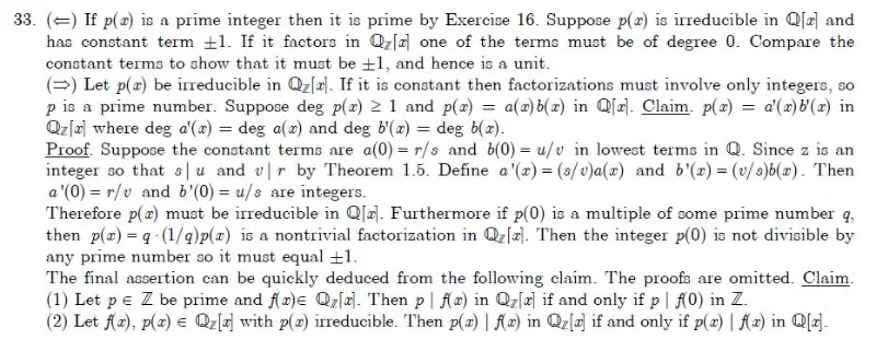

I found the written solution to the first part of the question, the part in my post. The solution is as follows:
Solution: If ##p(x)## is a prime integer then it is prime. Suppose ##p(x)## is irreducible in ##\Bbb{Q}[x]## and has constant term ##\pm 1##. If it factors in ##\Bbb{Q}_{\Bbb{Z}}[x]## one of the terms must be of degree ##0##. Compare constant terms to show that it must be ##\pm 1##, and hence is a unit.

I tried the same trick with the other direction, basically trying to prove that if ##p(x)\in \Bbb{Q}_{Z}[x]## is irreducible, then it is irreducible in ##\Bbb{Q}[x]##.
What I did is proved by contra-positive. I did the same thing you suggested in the other direction.
So suppose ##p(x)\in \Bbb{Q}[x]## is a non constant reducible polynomial and ##p(x)=a(x)b(x), a(x), b(x)\in \Bbb{Q}_{\Bbb{Z}}[x]##. Then ##a(x)b(x)\in \Bbb{Q}_{\Bbb{Z}}[x]## and hence must be reducible in ##\Bbb{Q}_{\Bbb{Z}}[x]## also. Otherwise, either one of ##a(x)## or ##b(x)## must be an unit, say ##a(x), \text{and } a(x)=\pm 1##. But ##a(x)b(x)\in \Bbb{Q}[x]## and this would mean ##p(x)=a(x)b(x)=\pm 1\cdot b(x)\in \Bbb{Q}[x]##. Then ##p(x), b(x)## are each other's associates with ##b(x)## being not an unit element of ##\Bbb{Q}[x]##, which in turn imply that ##p(x)## is irreducible in ##\Bbb{Q}[x]##, a contradiction.
Does the proof look alright to you. I know it sounds a bit verbose. I have to keep track which set the ##a(x),b(x)## are in for every statement.

This is what we need to show. You may not assume ##a(x),b(x)\in \Bbb{Q}_{\Bbb{Z}}[x].##
The statement is that irreducibilty in ##\Bbb{Q}_{\Bbb{Z}}[x]## implies irreducibilty in ##\Bbb{Q}[x].## This is equivalent to the statement that reducibility in ##\Bbb{Q}[x]## implies reducibility in ##\Bbb{Q}_{\Bbb{Z}}[x].##
Reducibility in ##\Bbb{Q}[x]## means that we have a factorization ##p(x)=a(x)b(x)## with factors ##a(x),b(x)\in \Bbb{Q}[x].##
The goal now is to modify these factors such that we get a factorization with polynomials ##a'(x),b'(x)## in ##\mathbb{Q}_{\mathbb{Z}}[x].##
But there is a problem. ##\mathbb{Q}_{\mathbb{Z}}[x]\subsetneq \mathbb{Q}[x]## is a proper subset. What if ##p(x)\not\in \mathbb{Q}_{\mathbb{Z}}[x]##? We have to rule out this case. This means that a contra-positive proof won't do. We need an indirect proof:
given: ##p(x)\in \mathbb{Q}_{\mathbb{Z}}[x]## irreducible.
to show: ##p(x)\in \mathbb{Q}[x]## is irreducible.
assumption: ##p(x)\in \mathbb{Q}[x]## is reducible.
goal: use ##p(x)=a(x)\cdot b(x) ## in ##\mathbb{Q}[x]## and construct a factorization ##p(x)=a'(x)\cdot b'(x) ## in ##\mathbb{Q}_{\mathbb{Z}}[x]## which contradicts the given condition, i.e. our assumption is false, and what we had to show is true.
The difference with that structure is, that we still have the given fact that ##p(x)\in \mathbb{Q}_{\mathbb{Z}}[x]## other than in the contraposition case where we have to deal with arbitrary polynomials of ##\mathbb{Q}[x].## Consider the polynomial ##p(x)=(1/2)x^2 \in \mathbb{Q}[x].## This polynomial is reducible in ##\mathbb{Q}[x]## but not in ##\mathbb{Q}_{\mathbb{Z}}[x].## It isn't even an element of ##\mathbb{Q}_{\mathbb{Z}}[x].## That's why we need an indirect proof. We must have ##p(x)\in \mathbb{Q}_{\mathbb{Z}}[x].##

No. You used what you wanted to show. We need to modify the factors:
p(x)=a(x)\cdot b(x)\in \mathbb{Q}[x] \Longrightarrow p(x)=a'(x)\cdot b'(x) \in \mathbb{Q}_{\mathbb{Z}}[x]
for some new factors ##a'(x),b'(x)\in \mathbb{Q}_{\mathbb{Z}}[x].##
Write it down explicitly:
$$p(x)=p_0+p_1x+p_2x^2+\ldots+p_nx^n=(a_0+a_1x+\ldots+a_sx^s)\cdot(b_0+b_1x+\ldots+b_tx^t)$$
where all coefficients ##p_0,\ldots,p_n,a_0,\ldots,a_s,b_0,\ldots,b_t \in \mathbb{Q}.##
What do we know about ##p_0## and why?
What do we need ##a_0,b_0## to be from and why?
How can we achieve this goal?
I think your proof is correct, and only formulated a bit clumsy. E.g., instead of an indirect proof, we can add ##p(x)\in \mathbb{Q}_{\mathbb{Z}}[x]## to the list of given conditions, i.e. saying that the contraposition doesn't hold for all rational polynomials, and only for those in ##\mathbb{Q}_{\mathbb{Z}}[x].##
I think the explicitly written polynomials help to clarify the principle. But you should definitely strictly distinguish between the two rings. This is very much about logic rather than it is about mathematics, so rigor is crucial.

In the attached solution, I don't think the proof is convincing. In particular from the point where it says "Since $z$ is an integer...." all the way to the end of that paragraph and also in the next paragraph "Then the integer $p(0)$ is not divisible by ....".
In the first part, where it says $a'(x)=(s/v)a(x)$ and $b'(x)=(v/s)b(x)$. Then $a'(0)=r/v$ and .... Well, I don't think this step is necessary, and also it is not convincing, since it seems it is there only for helping with the next part where $p(0)$ is not divisible by any prime number so it must be equal to $\pm 1.$ It is not convincing because in the next part, it doesn't really show why $p(x)=a(x)b(x)\in \Bbb{Q}[x], p(0)=\pm 1$ is irreducible in $\Bbb{Q}[x]$.
So here is what I did, we need to state which elements in both $\Bbb{Q}_{\Bbb{Z}}[x], \Bbb{Q}[x]$ are non-units.
For $\Bbb{Q}_{\Bbb{Z}}[x]$, the non-unit elements are $p(x)\in \Bbb{Q}_{\Bbb{Z}}[x]$ and $\text{deg}(p(x))\geq 0$, with $p(x)=\sum_{i=0}^{n}a_ix^i, p(0)=a_0\in \Bbb{Z}, a_n,a_{n-1},\ldots a_1\in \Bbb{Q}$.
For $\Bbb{Q}[x],$ because of the requirement for the condition, the only non unit element of $\Bbb{Q}[x]$ is a polynomial of the form $p(x)\in \Bbb{Q}[x], p(x)=\sum_{i=0}^{n}a_ix^i, p(0)=\pm 1, a_n,a_{n-1},\ldots a_1\in \Bbb{Q}$. [the solution never proved this, and I don't know how to prove it. This is the other reasons why i think the author's solution is not convincing because it is missing this vital step.]
If $p(x)\in \Bbb{Q}_{\Bbb{Z}}[x], p(x)=\sum_{i=0}^{n}a_ix^i, p(0)=\pm 1, a_n,a_{n-1},\ldots a_1\in \Bbb{Q},$ then $p(x)\in \Bbb{Q}[x]$ is automatically irreducible.
However if $p(x)\in \Bbb{Q}[x], p(0)=\pm 1, p(x)=a'(x)b'(x)\in \Bbb{Q}[x], a'(x),b'(x)\in \Bbb{Q}[x], p(x)=a'(x)b'(x), a'(x), b'(x)\in \Bbb{Q}_{\Bbb{Z}}[x],$ we can divide the construction of the polynomial $p(x)\in \Bbb{Q}[x]$ into two cases. In both cases, automatically $p(x)\in \Bbb{Q}_{\Bbb{Z}}[x]$.
Case 1: For any prime integer $p$, $a'(x)=a(x), a(0)=p, b(0)=\frac{1}{p}, b'(x)=pb(x). a'(x)b'(x)=a(x)(pb(x))=p$
Case 2: For any integer $m, n\in \Bbb{Z},$ with either being composite, say $n$, then $n$ can be factor uniquely as $n=s_1^{e_1}s_2^{e_2}\cdots s_k^{e_k}$ where each $s_i$ is some prime integer and $e_i\in \Bbb{Z}_{\geq 0}$ for $i=1,2,\dots k$. We pick an $s_i$ amongst the $s_1,s_2,\ldots s_k$. Then let $a(x),b(x)\in\Bbb{Q}[x], a(0)=n , b(0)=\frac{1}{n},$ $p(x)=a(x)b(x)\in \Bbb{Q}[x], a(x)b(x)=\pm 1,$ and let $a'(x)=a(0)s_i, b'(x)=b(0)$ then $a'(x)b'(x)\in \Bbb{Q}_{\Bbb{Z}}[x], a'(x)b'(x)=s_i or let $a'(x)=a(x), b'(x)=b(x)$ with $a'(0)=n, b'(0)=\frac{1}{n}$.
I think I covered all the cases. But i still don't know how to show for $p(x)\in \Bbb{Q}_{\Bbb{Z}}[x]\cap \Bbb{Q}[x], p(0)=\pm 1$ is a non-unit in $\Bbb{Q}_{\Bbb{Z}}[x]\cap \Bbb{Q}[x]$. Thank you in advance.

First, let me see whether I can understand the proof in the book, since you are referring to it. As a reminder ##\mathbb{Q}_\mathbb{Z}[x]=\mathbb{Z}+x\mathbb{Q}[x]=R## which I will abbreviate with ##R## for easier typing. The notation ##\mathbb{Q}_\mathbb{Z}[x]## is non-standard anyway, so I might as well call it ##R## for ring.
The exercise is about the difference between prime elements and irreducible elements.
A unit ##u## is an element in a ring that has an inverse, i.e. for which the equation ##u\cdot x=1## is solvable. The units in ##\mathbb{Z}## are ##\pm 1.## All other integers cannot be inverted within ##\mathbb{Z}.##
An element ##f## is irreducible if it cannot be written as a product of two non-unit factors, and reducible if such a factorization exists. We have to exclude units, since we can always multiply as many units to ##f## as we want without changing its irreducibility or reducibility. ##7\in \mathbb{Z}## is as irreducible as ##-7## is. The minus sign, a factor ##u=-1## does not change anything in terms of factorizations.
An element ##p## is prime if it is no unit (same argument as before, units won't change anything), and if
p\,|\,(a\cdot b) \Longrightarrow p\,|\,a \quad\text{ or }\quad p\,|\,b.
We learn at school that prime numbers are those that have only ##1## and themselves as divisors. However, that is the definition of irreducibility, not the definition of prime. The definition of prime is, that if it divides any product, then it must already divide one of the factors. ##6## divides ##3\cdot 4## but does neither divide ##3## nor ##4## so ##6## cannot be prime. But if ##3## divides any product ##n_1\cdots n_k## then ##3## has inevitably to divide one of the factors ##n_i.##
Irreducible elements of the integers are exactly the prime integers. The two definitions are equivalent in the ring ##\mathbb{Z},## which is why the school definition works. (Recommendation: prove this equivalence statement to practice your skills.)
Now, primality and irreducibility are not always the same. Exercise #33 is all about this fact. It can be rewritten as:
33. aa) (##\Longrightarrow ##) If ##p(x)\in R## is irreducible, then ##p(x)\in \mathbb{Z} ## is a prime integer or irreducible in ##\mathbb{Q}[x]## with a integer unit as constant term, i.e. ##\pm 1.##
ab) (##\Longleftarrow##) If ##p(x)\in \mathbb{Z} ## is a prime integer or irreducible in ##\mathbb{Q}[x]## with a integer unit as constant term, i.e. ##\pm 1,## then ##p(x)\in R## is irreducible.
b) Every irreducible polynomial ##p(x)\in R## is prime.
I think that we can agree that 33. aa) is correct, so far as exercise 16 is. If ##p## isn't a prime number, but irreducible in ##\mathbb{Q}[x],## and we write ##p(x)\in R## as a product, then it is also a product in ##\mathbb{Q}[x].## But ##p(x)## is irreducible there, so one of the factors must be a unit. The units in ##\mathbb{Q}[x]## are the rational numbers, so one factor is a rational number. Hence, we have
p(x)=\pm 1 + x\cdot f(x) = r\cdot (s+x\cdot g(x))=rs +rxg(x)
and ##p(0)=\pm 1=rs.## But ##r,s\in \mathbb{Z}## so ##r,s=\pm 1## and in particular, ##r=\pm 1## is a unit in ##R.##
So we are left with the cases 33. ab) and 33. b).
I will answer this in a new post.
@fresh_42 oh thank you for replying to my message. I have been feeling under the weather for this past week, again sorry for all my late replies. As for issue of latex, sometimes I type out stuff, and PF renders any tex into what you see in the first line in the below screenshot. The text are all messed up, even though the tex syntax are all correct. I thought it might be easier if I just tex it out using dollar sign and you can just check what i wrote using stackedit.io.
As to the question, I don't have a problem proving the last bit about prime elements. I just don't think in the other direction, Hungerford's solution made a convincing argument that ##p(x)\in \Bbb{Q}_{\Bbb{Z}}[x]\cap \Bbb{Q}[x], p(0)=\pm 1## is a non unit. I mean that is what both direction would imply as a consequence., also if we just drop the non-unit issue for second, proving that ##p(x)\in \Bbb{Q}[x], p(0)=\pm 1## is irreducible in assuming that ##p(x)\in \Bbb{Q}_{\Bbb{Z}}[x]## is not convincing, and it doesn't completely constructive especially in the last bit showing how the constant term has to be ##\pm 1##.
I am confused, too, by all these various variables. It always helps to sort out things. Remember, that the most important question in algebra is always: what if not?
Given: ##p(x) \in R = \mathbb{Q}_\mathbb{Z}[x]=\mathbb{Z}+x\mathbb{Q}[x]## is irreducible in ##R.##
If ##p(x)\in \mathbb{Z}\subseteq R## then ##p(x)=z## for some number ##z\in \mathbb{Z}.## We need to show that ##z## is prime. If it were not prime, then there would be a proper factorization ##z=a\cdot b## which is also a factorization of ##p(x)## in ##R,## which is impossible since ##p(x)## is irreducible.
Hence, we may assume that ##\deg p(x) \geq 1.## We have ...
to show ... that ##p(x)## is also irreducible in the larger ring ##\mathbb{Q}[x]\supseteq R## and that ##p(0)=\pm 1.##
This means that even with more available factors in ##\mathbb{Q}[x]## we should still be unable to find a proper factorization. What if not? If not, then there is a factorization ##p(x)=a(x)\cdot b(x)## with polynomials ##a(x),b(x)## from ##\mathbb{Q}[x].## Our goal must be to use this factorization and transform it into a factorization in ##R## from which we know it does not exist. Such a contradiction would imply that "what if not" was wrong, i.e. ##p(x)=a(x)b(x)## couldn't exist unless one of the polynomials would be a unit.
I find the proof in the book also a bit confusing, especially where the ##z## comes from. However, I think your calculation is a bit too complicated. We have
p(x)=a(x)\cdot b(x) \Longrightarrow p(0)=a(0)\cdot b(0)\in \mathbb{Z}
##a(0)## and ##b(0)## are rational numbers, say ##a(0)=\dfrac{r}{s}## and ##b(0)=\dfrac{u}{v}.## We know that ##\dfrac{r}{s}\cdot \dfrac{u}{v}## is an integer since ##p(x)\in R.## We also know (per assumption that the quotients are fully cancelled) that ##(r,s)## and ##(u,v)## are coprime. So all prime factors of ##v## must be prime factors of ##r## and all prime factors of ##s## must be prime factors of ##u.## Hence ##v\,|\,r## and ##s\,|\,u,## or in other words ##\dfrac{r}{v}\in \mathbb{Z}## and ##\dfrac{u}{s}\in \mathbb{Z}.## This means that we can define two new polynomials
\begin{align*}
a'(x)&=\dfrac{s}{v}\cdot a(x)=\dfrac{s}{v}\cdot (a(0)+xa_1(x))=\dfrac{s}{v}\cdot \dfrac{r}{s}+xa_2(x)=\dfrac{r}{v}+xa_2(x)\in R\\
b'(x)&=\dfrac{v}{s}\cdot b(x)=\dfrac{v}{s}\cdot (b(0)+xb_1(x))=\dfrac{v}{s}\cdot \dfrac{u}{v}+xb_2(x)=\dfrac{u}{s}+xb_2(x)\in R\\
\end{align*}
for some rational polynomials ##a_i,b_i.## The point is that we now have two new polynomials ##a'(x)## and ##b'(x)## which are both in ##R.## Finally,
a'(x)\cdot b'(x)= \dfrac{s}{v}\cdot a(x) \cdot \dfrac{v}{s}\cdot b(x)= a(x)\cdot b(x) = p(x).
Hence, we have transformed our assumed factorization over ##\mathbb{Q}[x]## into a factorization over ##R.## But such a proper factorization does not exist.
So one of the factors, say ##a'(x),## must be a unit of ##R.## Now the only units, invertible elements in ##R## are ##\pm 1.## But if ##a'(x)=\pm 1## then ##p(x)=\pm b'(x)## and ##p(0)=\pm b'(0)=\dfrac{v}{s}b(0)=\dfrac{u}{v}.## Now ##p(0)\in \mathbb{Z}## by definition of ##p(x).## This means ##v\,|\,u## which we assumed to be coprime. That means ##v=\pm 1## and ##p(0)=\pm u.##
Now, what is ##u##? We need to show that ##u=\pm 1.## What if not? If not, then there is a prime ##q\in \mathbb{Z}## such that ##q\,|\,u.## We can certainly write ##p(x)=q\cdot (1/q)\cdot p(x).## Let's look closer at the second factor. We have ##\left(\dfrac{1}{q}\cdot p(x)\right)(0)=\dfrac{1}{q}\cdot p(0)=\pm \dfrac{u}{q}\in \mathbb{Z}## since ##q## is a prime divisor of ##u.## But this is a proper factorization in ##R,## which is not possible by the choice of ##p(x).## So "what if not" was wrong, i.e., there is no such prime ##q.## But if there is no such prime, then ##u=p(0)=\pm 1## what had to be shown.
This was the proof for 33. ab). It was along the lines of the book, just a bit more detailed and without this strange ##z.## Books are usually right, at least up to typos.
