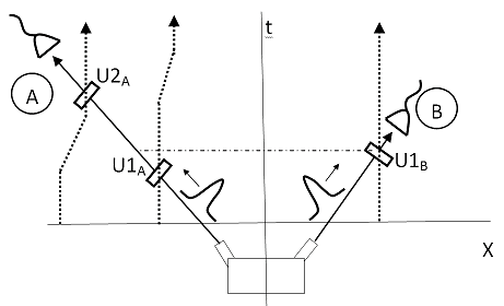

For example, say we have a two-photon source as shown below. U1A, U2A and U1B are optical elements (transforms) that could modify the prepared state in some way -- they would control the phases of various Feynman paths and thus control various interference effects.
But the world lines of U1A and U2A are such that we have effectively a delayed substitution of one for the other. If all the world lines are defined, how do we calculate the expected statistics such as coincidence counts etc which we know to be functions of U1A, U2A and U1B?
