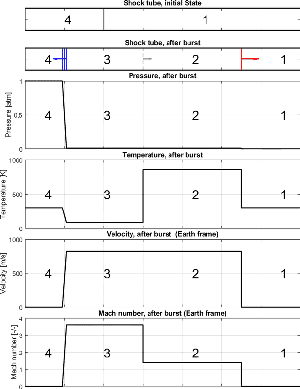

None of this is true in general. This is, in essence, a shock tube problem. Making a few assumptions (100 Pa air in the tube at 300 K, 101325 Pa air outside at 300 K), then if there is a clean rupture of some kind, the initial shock will travel at roughly Mach 3.15 into the tube. The temperature in the air compressed by the shock will be about 860 K at a pressure of 6981 Pa and with an incoming (to the pod) flow velocity of 821 m/s (so quite hot and fast, but still quite low pressure).
The details of the shock reflection will depend on the movement speed of the hyperloop pod and its front design. I could assume it is a piston moving down the tube to get an easy answer, but that violates one of Musk's central ideas, which is that the front of the pod would ingest the incoming flow. In that case, there may or may not even be a shock reflection.
This is of course a 1D approximation and the actual situation would be a hemispherical shock at the point of rupture. That would propagate down the tube and normalize, then the two shocks would meet (or would meet a solid wall) reflect, and come back to the rupture, further compressing the gas. However, the general order of magnitude should be correct for the initial pod encounter.
So the pod impacts a shock wave and some portion is ingested and some portion reflect. For now I will just assume perfect ingestion (not likely a great assumption but it simplifies things greatly and we have no other data to go on). The pod travels at 313 m/s (700 mph) meets a flow coming at it at 821 m/s while it travels at 313 m/s for a total relative velocity of 1134 m/s. At the compressed temperature, that equates to Mach 1.93. The resulting dynamic pressure is 18.18 kPa. The dynamic pressure before it encountered the shock was about 0.35 kPa.
Basically, it's a 50-fold increase in dynamic pressure and therefore a roughly 50-fold increase in drag. That said, it's still not a huge force. I'd imagine it would be felt as a jolt but nothing catastrophic. Far worse would be encountering whatever debris was leftover for the rupture.

Mass can only pass through a given sized hole with a given pressure ratio and temperature so fast. That "atmospheric bolt" is not going to be at atmospheric pressure or temperature because it had to accelerate to that given speed, which necessitates a temperature and pressure drop. The atmosphere is effectively infinite volume compared the the volume of the tube, so the slowing effect will be completely negligible and what is produced is a quasi-steady expansion into the tube once the initial wave system clears the hole and before any of those waves return.
As I stated before, the shock generated by the burst will accelerate the air in the tube to exactly the same velocity as the bolt of air coming into the tube from the atmosphere. There will still be a so-called contact surface between those two air masses across which velocity and pressure are constant but temperature is not.
Below is some figures illustrating the conditions in the simple shock tube approximation I used before (description below figure):
So basically, to describe that process, the two gases are initially at 300 K and separated by a diaphragm (the tube wall in the case of hyperloop) as shown in the top figure. The diaphragm bursts causing a shock (red) to propagate into the tube and an expansion wave (blue) to set up in order to accelerate air into the tube (second figure). A contact surface forms (gray) and travels downstream slower than the shock. Across the contact surface, pressure and velocity (figures 3 and 5) are constant but temperature (figure 4) varies due to the different reservoir condition and acceleration method from which each region was derived. That temperature interface will blur over time as diffusion (i.e. conduction in this case) occurs, but we are ignoring that effect here.
