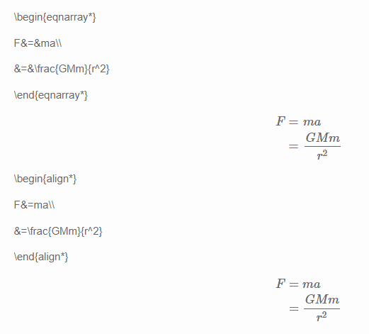

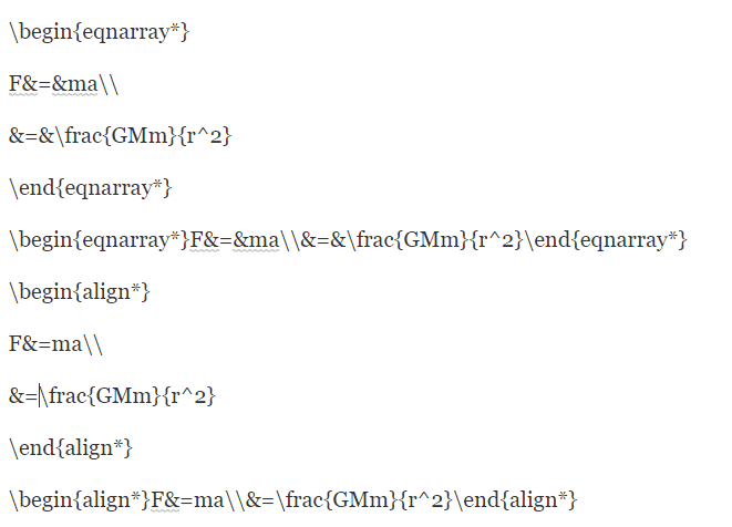

Input:
Output:
Conclusion:
1.) A manual carriage return leads to an unformatted / not interpreted output. So they must be avoided. Just type everything in a row and let the system perform the carriage returns.
2.) eqnarray* and align* lead to the same output. The first should be used for multiple tabulators per line, the second is sufficient for equations as in the example.
