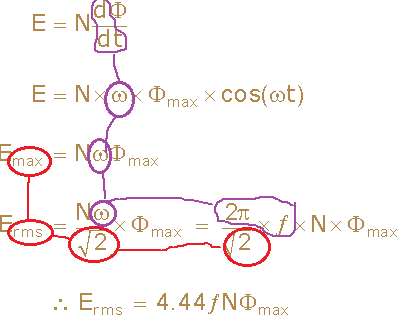

I understand this is an old thread but just wondering if you clarify one thing. Would I be correct in saying the 4.44 figure comes from 2π/√2=4.44, and that the √2 is there for the fact it is single phase? I was doing some reading and found this online, why has the RMS value been used on this rather than the max since the question asks for maximum flux?
Thanks,
Jason
https://www.electronics-tutorials.ws/transformer/trans6.gif
I would say you're exactly right.
for sine waves
ω = 2πf
and √2 is the ratio of peak to rms
Hats off to you for digging into understand the equations.
It's a lot easier than trying to remember them, isn't it ?
4.44 is slide rule accuracy.
With today's calculators you can postpone rounding off until the last step.
Sometimes textbook authors arrange their example problems so that pi's and √'s cancel out , and angles have convenient cosines.
That's when a little bit of such 'procrastination' just might pay off .
for sine waves
ω = 2πf
old jim
Yeah precisely the reason I don't just copy people who have done the question previous, I want to understand it so I can apply it more easily in future! Thanks for confirming that with the good explanation and picture also.
