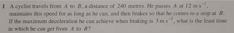

##s##=##ut##+##\frac {1}{2}####at^2##
This is the problem;
I tried using;
and ended up with, ##240## =## 12t -1.5t^2## clearly we have an imaginary solution here and therefore this may not be correct?
My wild guess is that the least time (Without deceleration) should take at least, ##t##=##\frac {240}{12}####=20##seconds

Okay, if he doesn't brake, then he takes ##20s## to travel ##240m## at ##12m/s##.
But, he needs to brake and come to a stop at ##B##.

True, I can't seem to find the solution. I have the textbook solution with me...I need input...I have taken a break just to refresh and think about this question...

If you were the cyclist, what would you do?

Of course decelerate...at which we have ##v=0## at point ##B##. We can't use ##v = u +at##, here as ##t=4##, is misleading.

When would you hit the brakes is the question?
PS do you know about the concept of "stopping distance", as it relates to road vehicles?

aaaaaaaaaaaaaaaaaaaaaargh i got it! Let me post my working.
Now when the brakes are applied ( retardation)...leading to point ##B##, this takes a total time of ##t=4## as earlier indicated in post ##6##. Now distance traveled in the last ##4## seconds is,
##48-24= 24 ## metres
Therefore the first portion of the journey takes ##t##= ##\frac {216}{12}=18##seconds.
Therefore the cyclist will travel atleast ##18+4=22## seconds. Phew!:cool:
