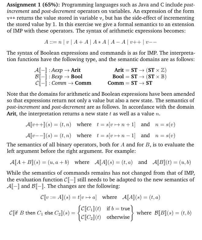

Hi, I need to implement a mini imperative language in Haskell but I'm struggling to get my head around it.
I need to implement an increment and decrement function like ++ and -- in other languages.
We've been given some skeleton code which we need to complete in order to run a factorial function using the decrement operator.
Here's the skeleton code:

This is mainly to teach me about the semantics and as such I've been given nothing the following definitions:
A[v++](s)=(t,n) where t=s[v􏰀→n+1] and n=s(v)
A[v−−](s)=(t,n) where t=s[v􏰀→n−1] and n=s(v)
This is my attempt so far, but I'm struggling the with Decr and Incr functions and I'm not sure if the rest of what I have done is correct.

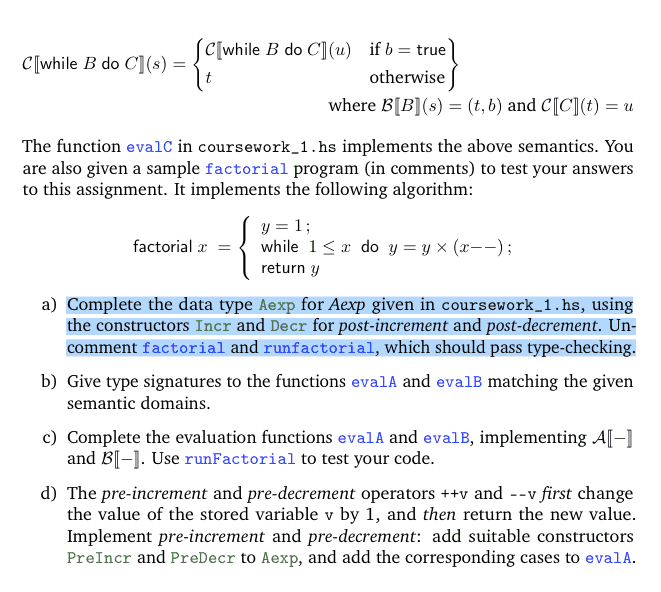

What symbol follows v in s[v􏰀→n+1]? It is not shown correctly in my browser.
Here is the relevant parts from the specification. I've taken a screenshot so you can see the symbols. :D
View attachment 4074View attachment 4075I've read through the other things you've said and put them in so my code now looks like this:
