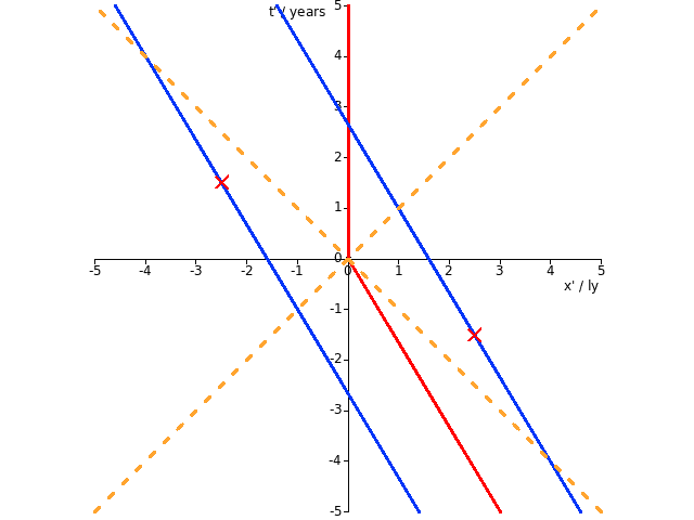

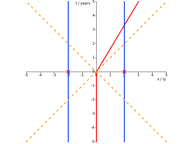

Here are a couple of Minkowski diagrams illustrating this scenario. The red line is the ship, which accelerates instantaneously to 0.6c. The blue lines are the two planets. The dashed lines show the light cone of the acceleration event, and the two red crosses denote parties held by mission control on the two planets, simultaneous with when they believe the ship accelerated. The first one is in the rest frame of the planets:
The second is in the rest frame of the moving ship:
The important thing to do is look at the red crosses representing the parties. In the initial frame, they happen two light years either side of the ship at the same time as the ship accelerates. In the final frame, they happen further apart and not simultaneously. And this causes a problem.
If I want to stick these frames together and say "how does the ship interpret this" then I might naively approach it as follows. I would cut the top off the first diagram (because that's "after the acceleration") and the bottom off the second diagram (because that's "before the acceleration") and stick them together. But what about the parties? Depending on which side of the cut they fall, one of them never appears or one of them appears twice. Does the ship's crew really think this? How do they explain being able to hear the party in mission control over the radio if it never happened?
The problem is that the cuts through the two diagrams aren't parallel, because the two frames' notions of simultaneity aren't the same. The cut on the first diagram goes through the two party events - but just look at the slant on that line in the second diagram! My naive synthesised diagram covers some of spacetime twice and some of it not at all. And this is why you get funny effects like "the planet suddenly jumps closer". Before the acceleration, you said "now on the planet" was its red cross. Afterwards, you say it's where its blue line crosses the x' axis. You aren't comparing apples to apples.
You need a non-inertial frame to do the description properly. I'm rather partial to Dolby and Gull's radar coordinates for this - see https://arxiv.org/abs/gr-qc/0104077. The end result is that they take the past light cone from the first diagram (which everyone agrees is the past), the future light cone from the second diagram (which everyone agrees is the future), and synthesises a smooth transition between the two in the spacelike-separated regions.
