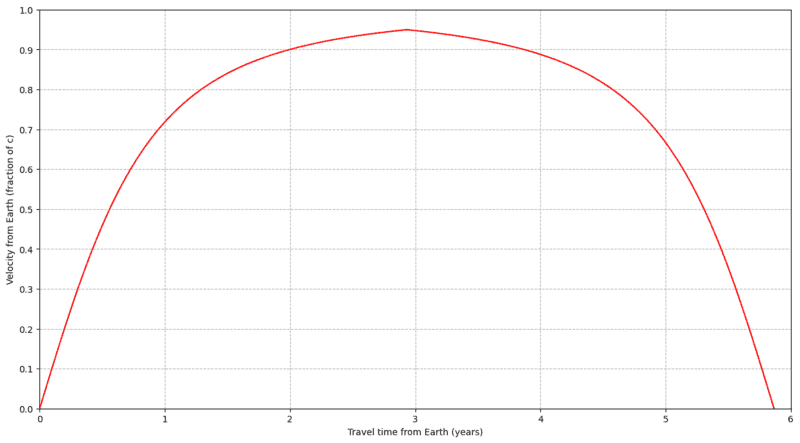

I want to calculate length contraction from Earth to Proxima Centauri in the reference frame of a spaceship that is moving with acceleration between those two points.
Let's assume a spaceship traveling from the Earth to the Proxima Centauri with constant acceleration g = 9.81 m/s2.
The ship is accelerating the first half of the trajectory and decelerating the second half.
I calculated the velocity profile from the Earth reference:
The travel time on the spaceship is calculated to be 3.54 years due to the time dilation.
In order to calculate the length contraction from Earth to Proxima Centauri, I started with the formula:
where l0 is length from the Earth reference.
Then I insert the velocity formula:
but I am not able to calculate the integral since the independent variable is length l instead of time t.
How can I calculate length contraction for such accelerated motion? I want to calculate the length from Earth to Proxima in the ship frame.

According to my understanding of the velocity profile in the OP, the rocket accelerates between the two meeting events of the twins only towards the earth. Then only one Rinder frame is needed.
I disagree - the velocity is initially zero, rises to a maximum, then falls back to zero. The acceleration is also discontinuous at the middle. This is a one-way trip with a turnover in the middle.
The total time is the same as various other scenarios where ##|\alpha|## is constant, yes.
You are correct. I overlooked, that the diagram in the OP is a velocity / time diagram instead of a spacetime diagram.
