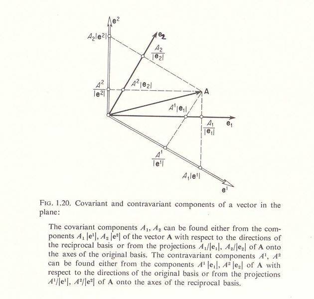

But on p. 28 of Vector and Tensor Analysis, Borisenko and Taparov label the orthogonal projections of a vector they call A onto the unprimed basis vectors
[tex]\frac{A_{i}}{||\mathbf{e_{i}}||}[/tex]
and call [tex]A_{i}[/tex] the covariant components. So is Griffel reversing both the sub/superscript convention and the names "contravariant" and "covariant" components (with the exception of the practice of putting a subscript for the basis vectors [tex]\mathbf{e_{i}}[/tex] on which point he agrees with the others, or is there something deeper to it?
By which I mean the basis vectors of the original basis, that Borisenko and Taparov with subscripts.
[tex]\left\{ \mathbf{e_{1},...,\mathbf{e_{n}} }\right\}[/tex]
(See attachment.)
I wonder if the anomaly could be because Griffel really has used a different method of introducing these ideas which somehow allows him to use subscripted basis vectors (i.e. the kind of basis vectors which other authors denote with superscripts), where - if he'd been following the usual way of introducing it - he'd have denoted them with superscripts (to indicate the same sort of basis vectors that other authors denote with subscripts). Whatever that might mean...
