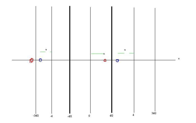

Two infinite grounded parallel conducting planes are separated by a distance d. A point charge q is placed between the planes. Determine the induced surface charge densities as well as the total charges on the two planes.

I chose the x-axis to be perpendicular to the plates, with the plates at ±d/2, and the point charge q at some location a, 0<a<d/2 (it doesn't matter where, but I wanted it on the positive side of the x-axis).
Using the method of images, since both plates are grounded (zero potential), we need a point charge -q at x=d-a to balance the right plate. But then to balance the left plate we need a charge q at x=-2d+a and a charge -q at x=-2d-a. This process needs to be repeated an infinite number of times for the image charges to recreate the boundary conditions. They form a pattern where charges of q are located at x=±2nd+a and charges of -q at x=±(2n+1)d-a, where n is a non-negative integer (0, 1, 2, ...).

I actually think the first series is wrong anyway, it should have four terms, since there are ± signs for the locations of the image charges, and I moved to cylindrical coordinates with x running along the axis of the cylinder
[tex]\Phi(x,r)=q\sum_{n=0}^{\infty}\left(\frac{1}{\sqrt{(x-2nd-a)^2+r^2}}+\frac{1}{\sqrt{(x+2nd-a)^2+r^2}}-\frac{1}{\sqrt{(x-(2n+1)d+a)^2+r^2}}-\frac{1}{\sqrt{(x+(2n+1)d+a)^2+r^2}}\right)-\frac{q}{\sqrt{(x-a)^2+r^2}}[/tex]

I'm still not too sure abut your series...if the plates are at [itex]x=\pm\frac{d}{2}[/itex], shouldn't you have image charges of alternating sign at [itex]x=d-a,\;\frac{3}{2}d-a,\;2d-a,\;\text{etc.}[/itex] to balance the right-hand plate and image charges of alternating sign at [itex]x=-d+a,\;-\frac{3}{2}d+a,\;-2d+a,\;\text{etc.}[/itex] to balance the left-hand plate, and of course your original charge at [itex]x=a[/itex] leaving you with something like:
[tex]\Phi(x,y,z)=q\sum_{n=0}^{\infty}\left[\frac{(-1)^{n+1}}{\sqrt {(x+\frac{n+2}{2}d-a)^2+y^2+z^2}}+\frac{(-1)^{n+1}}{\sqrt{(x-\frac{n+2}{2}d+a)^2+y^2+z^2}}\right]+\frac{q}{\sqrt{(x-a)^2+y^2+z^2}}[/tex]
I'm pretty sure on it, I drew a picture of how I reasoned the locations. Blue dots are -q charges and red dots are +q charges, the plates are the thick black lines (sorry for the bad mspaint picture).
Yes, I suppose you will actually have image charges of alternating sign at [itex]x=d-a,\;2d+a,\;3d-a,\;\text{etc.}[/itex] to balance the right-hand plate and image charges of alternating sign at [itex]x=-d-a,\;-2d+a,\;-3d-a,\;\text{etc.}[/itex] to balance the left-hand plate. Giving,
[tex]\Phi(x,y,z)=q\sum_{n=0}^{\infty}\left[\frac{(-1)^{n+1}}{\sqrt {(x-(n+1)d+(-1)^na)^2+y^2+z^2}}+\frac{(-1)^{n+1}}{\sqrt{(x+(n+1)d+(-1)^na)^2+y^2+z^2}}\right]+\frac{q}{\sqrt{(x-a)^2+y^2+z^2}}[/tex]
Which is equivalent to your series in post #3.:approve:
