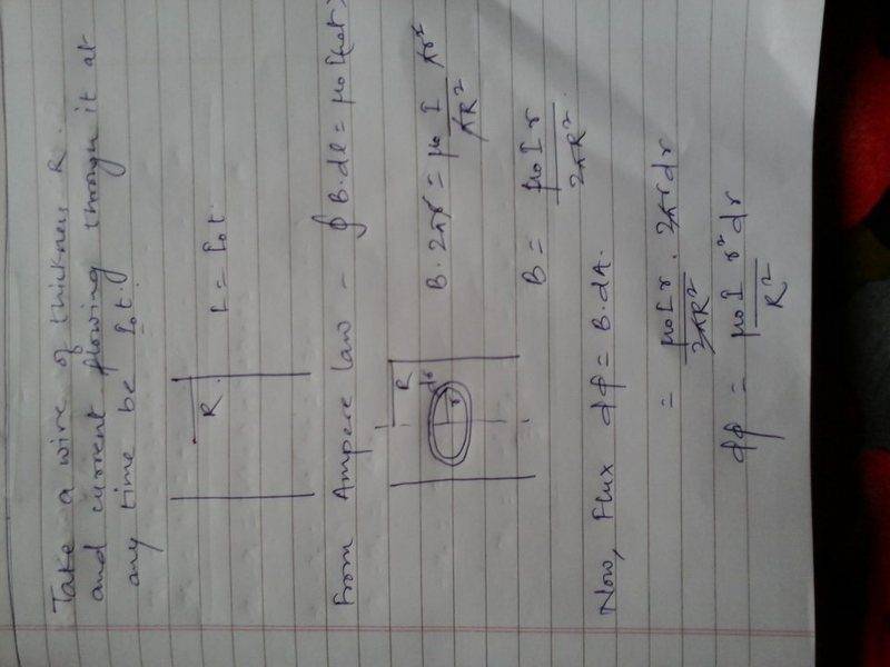

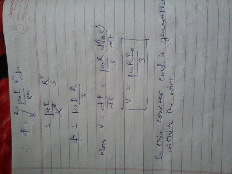

The question is really simple you are thinking it much than its required solve within the wire and you will get counter emf and differential of it with length will give you E vector. I am giving one example to show how to work for these problems.
If your question is different than this wirte the question properly and i will solve that and reply it.
I am looking for the electric field outside of the wire, not the emf inside of the wire. If current is changing ∂I/∂t ≠ 0 then there is a changing magnetic field outside the wire that must produce some non electrostatic electric field outside of the wire also.
