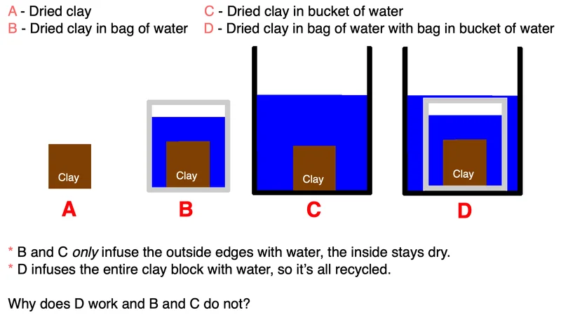

If I put clay in a bag of water, tie it up, put it in a bucket, the water permeates the clay - but why doesn't it do that in a big of water or just in the bucket alone?
I'm not a physicist or even a physics student, I'm a pottery student and there's a conundrum that's been puzzling potters in my area for a while. We've found that if a block of clay dries out, the fastest and best way to revitalize the clay is to put it in a bag of water, tie the bag so it's sealed, then put it in a 5 gallon bucket of water. In the diagram, that's D:
If we take the clay and put it in a bag of water, like in B, and let it sit for several days, the water has permeated the outside layers of clay, but only about 1" into the block. The same with C - if we take the clay and put it in a 5 gallon bucket of water, only the outer inch gets revitalized (or, probably a better term is remoisturized). But if we put the clay in the bag of water, the in the bucket, as in D, and fill it to the same level as we did in C, within 2 days, the entire block of clay is good for use - water has permeated through the entire block.
I've tried asking this in some physics forums and been told it's a chemistry issue, but when I ask in chemistry forums, I get responses that say something along the line of, "I think it's because..." but never a clear answer. (I've also had physics forums reject it because I couldn't include images in the question or had to ask the full question in the title and didn't know how to summarize it clearly in that short a space.) From what replies I have seen, it seems like it has something to do with pressure, but I don't understand why there would be more pressure in D than in C. (Or, even, since it's not even 18" of water depth, in B.)
Why does the clay get fully permeated in D but not in B or C?
Could it be a temperature difference? 18” of water is about 0.05 atmospheres, so it is some pressure but not a lot.

I think the density, from least to highest, would be:
1. Water
2. Clay
3. Infused clay
4. Clay edges infused with more than "normal" water. (And 3 & 4 might be reversed - not so sure!)
In B and C, when you put the clay in the water, it displaces water and the water and the outside water will have enough pressure to push water into the clay. As it does, the amount of water displaced goes down. Here's the part I'm unsure of, and I think the water infuses only into the clay to the point where the water pressure on the clay is no longer strong enough to infuse the clay anymore. (I've also tried to think through this and can see that the water infused into the outer edges of the clay may be equal to something to do with the difference of density of the clay and the density of water.)
The same thing happens like this in both B and C.
In D, you put the clay in the bag and seal it and you have the clay displacing water in the bag. Then you put the big in the bucket and the bucket water will apply enough pressure to try to make the bag shrink ot the size of the amount of water being displaced. So now the water in the bag is not only creating pressure to infuse the clay, but it has outside pressure that will push on the bag to try to make it as small a displacement as possible.
Now there's the inside pressure in the bag, that is pushing out against the bag, but also into the clay. But as long as it can continue to push water into the clay, it will not be pushing against the bag and against the bucket water pressure until as much water as possible has been absorbed by the clay.
So the displacement of the bag in the bucket is going to add extra pressure on the water inside the bag to reduce the displacement of the clay and that will be more pressure than what you get when you put the clay only in the bag or in the bucket.

The hydrostatic pressure at the clay surface will be the same whether the clay is enclosed in a bag, or free. While higher pressure could be of value, I conjecture it probably is not of great importance in this experiment, being of such low head.
The action of water infiltration is less sensitive to the water pressure, than it is to capillary action as the water moves into the clay pores, and from pore to pore as the clay is rehydrated.
A plastic bag is not impervious to gas or water, some types of plastic being less or more so depending upon composition and thickness.
Situations B and C are the same - a clay form surrounded by water.
D is different in that the plastic bag is employed as a permeable membrane allowing gas, water, perhaps ion exchange between the fluid within the bag and that without. ( within and without should be antonyms, and if not, I just made then so ).
Question is what is the difference between the two separate waters that would allow more water infiltration into the clay. Has the pH level changed due to dissolution of clay salts or compounds rendering the clay less hydrophobic in a general sense? CO2 content, O2 content?
I am throwing out some chemistry. Hopefully some will stick. What the actual mechanism truly is might be found with testing the water content of the interior. ( personally, I lean to pH, as clays are more basic than acidic, but that is only a hunch ).

With regards to B vs D: Is the bag really so full of water, that it has the same shape as in D, as shown in the picture? Or does it sag to the bottom, and stick to the clay at the top?

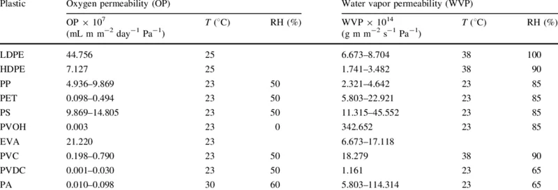

Pore size of plastic film is very small, much more so than the experiments that show the surface tension of water not allowing water to escape say from an eye dropper.
some literature.
https://www.researchgate.net/figure...tic-films-used-in-packaging-17_tbl1_225207929
Polymers and plastics are permeable and their barrier properties may impact their suitability for a specific application. In packaging, for example, ineffective barrier properties for plastic films may render the enclosed product vulnerable to surrounding environmental factors, such as water, humidity, and oxygen, including its future storage.
https://www.intertek.com/polymers-plastics/barrier-properties/
The main gases that affect the shelf life and packaged stability of most products are oxygen and water vapour and so we provide Water Vapor Transmission Rate (WVTR) via industry established methods ASTM D1653, Water Vapor Transmission of Organic Coating Films and ASTM E96 Water Vapor Transmission of Materials. We can also provide testing to ASTM F1249, Standard Test Method for Water Vapor Transmission Rate Through Plastic Film and Sheeting Using a Modulated Infrared Sensor and ISO 15106-2, Plastics - Film and sheeting - Determination of water vapour transmission rate.
The Oxygen Transmission Rate (OTR) is an important determinant of the packaging protection afforded by barrier materials particularly for film, sheeting, laminates, coextrusions, or plastic-coated papers. We measure the OTR via ASTM D3985, Oxygen Permeation of Flexible Barrier Materials Using a Coulometric Sensor ASTM D3985, ISO 15105 to determine the permeability coefficient, permeance and transmission rates.
Uh - well, I'm not really that much of an artist and not good at drawing! So I just used the square shape because it was quick and easy. But the clay bags are not much bigger than a full block of clay. However, there are times when you're recycling half a block. I fill the bag until the water almost covers the clay. The video linked to above uses less water. I hear some cover the clay. I try to squeeze as much air out as I can. But, yes, some water will make the bottom of the bag spread out and the top, where I tie off the bag, it fits closer to the clay in it. But there is water (at least when I do it) around the clay up until near the top of the clay.

ImaginaryTango said:
I can follow that reasoning and see how it makes sense. I don't think anyone puts clay in water but leaves the top uncovered. But if you put the clay in a bag of water, generally there's still some air there and I would think the air would be able to escape. But this leads to why does D work and not B, by itself?
The idea is that with water on all sides, the clay is effectively sealed. Any air in the lump of clay cannot escape without forming a bubble in the surrounding water. No bubble can form because surface tension prevents it.
The pressure that it takes to inflate a bubble increases as the bubble size decreases. For a sufficiently small bubble, significant pressure can be resisted.
That is why B does not work.
In case D with the clay in a bag, there is likely a portion of the clay surface exposed to the air. Air in the clay can be expelled through this surface without the need to create or inflate a small bubble.
Putting this together with the next paragraph, then it seems to me that B should work if there is some air left in the bag so the top of the clay is in that air pocket. Is that right?
So D would depend on the bag not being filled completely and having air in there?
TL;DR: If I put clay in a bag of water, tie it up, put it in a bucket, the water permeates the clay - but why doesn't it do that in a big of water or just in the bucket alone?
The drawings seem to indicate an air pocket in the bag. Is that the case?
A.T. said:
Yes, but C doesn't have the same suspended clay concentration as D, where the suspended clay is prevented from dissipating throughout the whole bucket by the bag.
Note that they both seem to have about the same effectiveness, though - they infuse the clay a ways in, maybe as much as an inch.
I though B & C have about the same effectiveness, while D works better than B & C. I was comparing C & D above, not B & C.
If D works better than C, just by having a bag-wall closer to the clay, than the container walls in C, then it's likely because the bag prevents/slows some kind of exchange/transport in the water that happens more in C than D. It could be ions, heat, gases or similar. To narrow this down, one would have to do controlled experiments, while measuring temperature, pH-level, pressure, etc. in the bag-water for D vs container water for C.
There is some. Like I said, I have no drawing skills, so I used an easy paint program. Generally I (and I hear other potters) will try to squeeze or burb the air out. But most of the time you're working with a cube or partial cube of clay - or lumps of it, and you're not going to get all the air out of it. I fill the bag to almost cover the clay, but not completely. Now that this could be part of the issue, I realize I've never asked if any potters cover the clay with water. I'm pretty sure local "lore" is to partially fill the bag.
If I misstated, I got the letters confused. To clarify: B & C have the same results: The outside part of the clay absorbs water, not the inside. Sorry if I got things mixed up!
Also, again, D works better than B - but I think that's covered when you say the bag prevents or slows some kind of exchange - but wouldn't it be that it allows or speeds up an exchange, not slowing it down?
And it sounds like you're saying that without more information, we don't know. Is that right?
Do do a full controlled experiment would be tough for me due to the need for regular measurements and tools I don't have. Also, another issue is to make the experiment fully controlled, I'd have to use the same clay body in each one and dry out the cubes of clay in the same fashion. So it's not just the water factors, which would be hard to control and measure here, but the clay factors - and those would be even harder to control.
