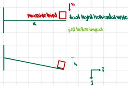

A massive bird lands on a taut light horizontal wire. You observe that after landing the bird oscillates up and down with approximately simple harmonic motion with period ##T##.
You notice that during the initial oscillations the maximum height the bird reaches above its initial position at landing is equal to the distance below its landing position at which the bird finally comes to rest, when all oscillations have stopped.
In terms of only ##T## and ##g##, the acceleration due to gravity, estimate the magnitude of the vertical velocity that the bird had at the instant of landing.
Here is a picture of the situation
Let's model the wire as acting like a massless spring with spring constant ##k##.
Let's define our coordinate system to be a ##y##-axis that has zero at the initial position of the wire (the landing position, and the equilibrium position of the spring).
At the bottom of the harmonic motion, velocity is zero and the gravitational force has same magnitude and opposite direction to the spring force.
$$mg\hat{j}-kh\hat{j}=0\implies h=\frac{mg}{k}$$
Let's define the gravitational potential energy to be zero at ##h##. Then, the gravitational potential energy is
$$U_g(y)=mg(h-y)$$
and the spring potential energy is
$$U_s(y)=\frac{ky^2}{2}$$
Let's consider our system to be just the bird. There are two conservative external forces acting on the bird: the force of gravity and the spring force. Thus, mechanical energy is conserved and we can equate initial to final mechanical energies.
$$U_{g,i}+U_{s,i}+K_i=U_{g,f}+U_{s,f}+K_f$$
$$mgh+\frac{mv_i^2}{2}=\frac{kh^2}{2}\tag{1}$$
If we sub in ##h=\frac{mg}{k}## and solve for ##v_i## we obtain
$$v_i=\pm g\sqrt{-\frac{m}{k}}$$
and if we use ##T=\frac{2\pi}{\omega}## and ##\omega=\sqrt{\frac{k}{m}}## then we find that
$$v_i=\pm \frac{gT}{2\pi}i$$
This is a complex number. Now, I do not think this is correct. In fact, from the resources I am using it seems the initial velocity is
$$v_i=\frac{\sqrt{3}gT}{2\pi}$$
which is what would be obtained if in (1) we had ##-mgh## instead of ##mgh##.
What (probably silly) mistake am I making here?
Here is your silly mistake
The velocity is indeed zero but the acceleration is not. Zero velocity does not necessarily mean zero net force. The forces are balanced at the equilibrium point where the bird finally comes to rest.
That said, you can make your analysis simpler if you ignore gravity and treat the problem as a horizontal spring-mass system with the amplitude of oscillations measured from the equilibrium position of the bird.
Okay, what if I disregard the assumption of simple harmonic motion and just consider two states: right before landing on the wire, and after the motion has been damped so that the bird is at rest on the wire?
Is the final state not one in which ##mg\hat{j}-kh\hat{j}=0##?
I think I do get this. The gravitational force on the bird is constant and simply generates an offset in the spring's equilibrium position. At position $$\frac{mg}{k}$$ the gravitational force and the spring force offset one another. Simple harmonic motion occurs about this position.
Changes in ##g## don't affect the frequency or period, but changes in ##k## do because it is the spring force that is generating the SHM (which originates from the homogeneous solution to the differential equation of motion). Gravity is present in the inhomogeneous term, which is just a constant external input that generates a constant term in the solution but not oscillations.
Ignoring gravity, as you suggest, means considering just the homogeneous equation of motion, which is what generates the oscillations.
Yes that is the final state.
Right. What is the amplitude of the motion? How is the amplitude related to the total energy of the oscillator before any significant amount is damped?

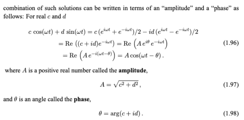

I will do these calculations right now. I do have a question about the math involved, if I may.
Consider the following calculation.
This way of doing these calculations using complex exponentials is interesting and new to me, but I don't quite understand it yet. In particular, in the second line, why do we take the real part of that specific expression?

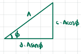

Up to this point, I would do these calculations in the following way
$$c\cos{\omega t}+d\sin{\omega t}$$
We search for an angle ##\phi## such that ##c=A\cos{\phi}## and ##d=A\sin{\phi}##. This can be visualized as follows
Then
$$A=\sqrt{c^2+d^2}$$
$$\phi=\tan^{-1}{\frac{c}{d}}$$
and
$$c\cos{(\omega t)}+d\sin{(\omega t)}$$
$$=(A\cos{(\phi)})\cos{(\omega t)}+(A\sin{(\phi))\sin{(\omega t)}}$$
$$=A(\cos{(\omega t)}\cos{(\phi)}+\sin{(\omega t)}\sin{(\phi)})$$
$$=A\cos{(\omega t-\phi)}$$
I am asking about this because this calculation is needed to calculate the amplitude of the oscillation of the problem in the OP. I'd like to do it using complex exponentials.
Here is what I think
We have
$$c(e^{i\omega t}+e^{-i\omega t})/2-id(e^{i\omega t}-e^{-i\omega t})/2$$
and if we group these terms in a specific way
$$=\left (\frac{ce^{i\omega t}}{2}-id\frac{e^{i\omega t}}{2}\right )+\left (\frac{ce^{-i\omega t}}{2}+id\frac{e^{-i\omega t}}{2}\right )$$
Then it turns out that if we check the real part of either of the expressions in parentheses we get the original expression.
So, as far as I can tell, the answer to my question is simply that this is an algebraic truth. I guess my question originated from the fact that this step was merely presented without explanation in the book. Now that I checked I can see it is true.
