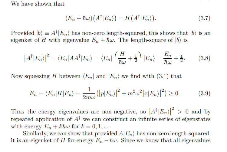

Hi guys, I'm not sure how to evaluate this inner product at step (3.8)

Okay, I got step 3.8. But For Step 3.9, I'm having a slight issue here:
[tex]E_n = <E_n|\hat H|E_n> = \frac{1}{2m}<E_n|(m\omega \hat x)^2 + \hat {p}^2|E_n>[/tex]
[tex]= \frac{1}{2m}(m^2\omega^2)<E_n|\hat x \hat x|E_n> + \frac{1}{2m}<E_n|\hat p \hat p|E_n>[/tex]
Using ##\hat x|\phi> = x|\phi>## and ##\hat p |\phi> = p|\phi>##,
[tex]= \frac{1}{2m}(m^2\omega^2)<E_n|\hat x x|E_n> + \frac{1}{2m}<E_n|\hat p p|E_n>[/tex]
Removing the last "hats" from ##\hat p## and ##\hat x## and Using orthogonality ##<E_n|E_n> = 1 ##:
[tex]= \frac{1}{2m}\left ( (m\omega x)^2 + p^2 \right )[/tex]
Is it wrong to assume that the energy eigenkets have norm = 1? That would be strange because later we show that ##E_n = (n + \frac{1}{2})\hbar \omega##
And, why is there an additional factor of ##\frac{1}{\omega}## in the expression?

Ok, then I have no idea what's gone wrong with my working..
The energy eigenket is not an eigenket of either x nor p. You need the ladder operators to evaluate the matrix elements.

How did they get 3.9 then?
<p E_n, p E_n> = ||p |E_n> ||^2 = <E_n, p^2 E_n>, because the eigenkets of energy are in the domain of both p and p^2, on which the 2 operators are essentially self-adjoint. p^2 is a positive operator, hence the inequality at the end.
The same goes for x.
I just don't get how ##<E_n|\hat x \hat x|E_n> = |x|E_n>|^2## and ##<E_n|\hat p \hat p|E_n> = |p|E_n>|^2##

[itex] <br /> That is true, but ##\hat x## and ##\hat p## are operators.. so the x and p in the norm should have hats?<br /> <br /> ##<E_n|\hat x \hat x|E_n> = |\hat x|E_n>|^2## and ##<E_n|\hat p \hat p|E_n> = |\hat p|E_n>|^2##[/itex]
they do have hats... the person who wrote the things in the image you posted, doesn't use hats so much...
You can get a feeling there must be hats because otherwise there would be no reason to use the eigenvectors in kets... (he'd get 1)
