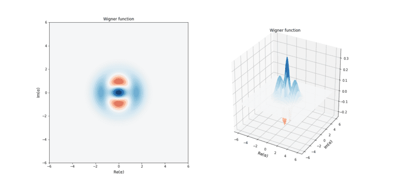

A plot function generating 2D and 3D to see how the result looks like.
Gallery of Wigner Function:
def plot_wigner_2d_3d(psi):
    #fig, axes = plt.subplots(1, 2, subplot_kw={'projection': '3d'}, figsize=(12, 6))
    fig = plt.figure(figsize=(17, 8))
    ax = fig.add_subplot(1, 2, 1)
    plot_wigner(psi, fig=fig, ax=ax, alpha_max=6);
    ax = fig.add_subplot(1, 2, 2, projection='3d')
    plot_wigner(psi, fig=fig, ax=ax, projection='3d', alpha_max=6);
    plt.close(fig)
    return fig

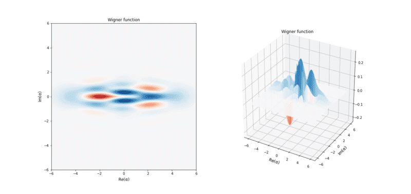

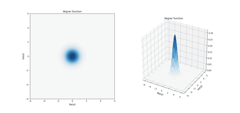

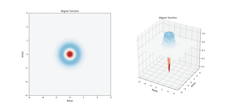

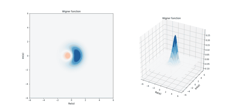

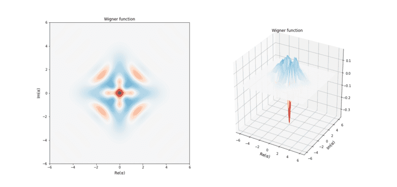

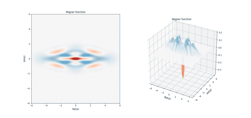

The first step
$$ \vert \Psi_i \rangle = \vert 0 \rangle \otimes \vert g \rangle$$
System in Ground State:
psi1 = tensor(basis(2,0), basis(2,0))
plot_wigner_2d_3d(psi1)
The second step
$$\vert \Psi \rangle = \frac{1}{\sqrt{2}}\vert 0 \rangle \otimes [\vert g \rangle + \vert e \rangle ] $$
Superposition of Ground and Excited State by applying a drive pulse:
psi2 = tensor(basis(2,0), (basis(2, 0) + basis(2, 1)).unit())
plot_wigner_2d_3d(psi2)
The third step
$$\vert \Psi \rangle = \frac{1}{\sqrt{2}} [ \vert 2\alpha \rangle \otimes \vert g \rangle + \vert 0 \rangle \otimes \vert e \rangle] $$
Coherent State Coupled to the Ground State by applying a drive pulse:
psi3a = tensor(coherent(2, 2.0), basis(2,0))
psi3b = tensor(basis(2, 0), basis(2, 1))
psi3 = psi3a + psi3b
plot_wigner_2d_3d(psi3)
The fourth step
$$ \vert \Psi \rangle = \frac{1}{\sqrt{2}} [ \vert 2\alpha \rangle + \vert 0 \rangle ] \otimes \vert g \rangle$$
The qubit flips the excited state back to the ground state when the cavity is in the ground state by applying a drive pulse:
psi4 = tensor(coherent(2, 2.0) + basis(2,0), basis(2,0))
plot_wigner_2d_3d(psi4)
The fifth step
$$\vert \Psi \rangle = \frac{1}{\sqrt{2}} [ \vert \alpha \rangle + \vert -\alpha \rangle ] \otimes \vert g \rangle $$
transform the state by displacing an amount of −α by driving a pulse to the cavity:
psi5 = tensor(coherent(2, 1.0) + coherent(2, -1.0), basis(2,0))
plot_wigner_2d_3d(psi5)
Likes vanhees71

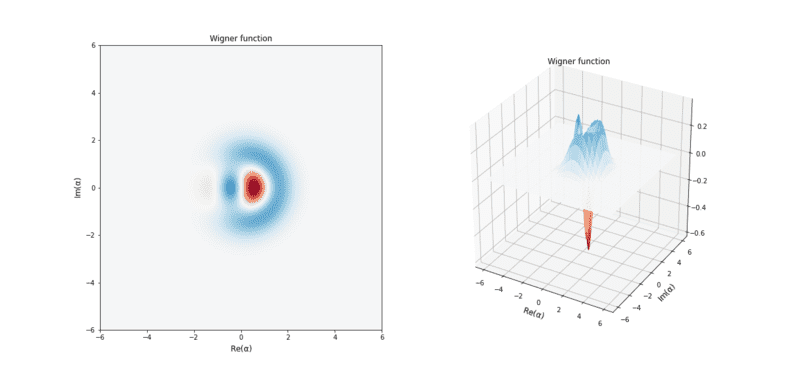

I think I have made a mistake in my above plots
https://www.physicsforums.com/threa...cat-state-in-circuit-qed.1048821/post-6840193
since I forgot to include 1/√ 2 to the states for normalisation.
As the microwave resonator is coupled to the two levels of superconducting qubit, I can set N = 20. Assume that ground state is 1 in basis and excited state is 0 in basis, I think it is a common practice. Here I set α as 1, I am not sure if it is appropriate.
Step 1
Code:
psi1 = tensor(basis(N,0), basis(2,1))
Step 2
Code:
psi2 = tensor(basis(N,0), ((basis(2, 1) + basis(2, 0)) / np.sqrt(2) ))
Step 3
Code:
psi3a = tensor(coherent(N, 2.0), basis(2,1))
psi3b = tensor(basis(N, 0), basis(2, 0))
psi3 = (psi3a + psi3b) / np.sqrt(2)
Step 4
Code:
psi4 = tensor((coherent(N, 2.0) + basis(N,0))/ np.sqrt(2), basis(2,1))
Step 5
Code:
psi5 = tensor((coherent(N, 1.0) + coherent(N, -1.0)) / np.sqrt(2) , basis(2,1))
plot_wigner_2d_3d(psi5).savefig('psi5.png')
Although I know Wigner function represents the probability distribution, I cannot interpret those graphs.
I hope someone can shed me some lights, or even ask me some questions for clarity. Thanks a lot!
