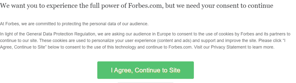

A newspaper report that over-simplifies the physics and lacks a one-touch 'global' cookie opt-out ?
Sadly, that's not news...
