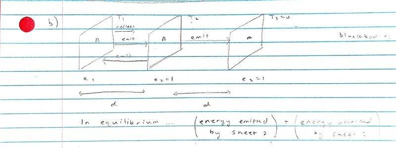

A sheet (“sheet 1”) of area A having emissivity ##e_1## is held at temperature ##T_1## so that it emits a total power ##P_1## to the right (i.e., energy per unit time). Let σB be the Stefan-Boltzmann constant and neglect all edge effects.
a. In terms of ##P_1##, calculate temperature ##T_1## of sheet 1.
Two additional black sheets, each of area A and having emissivities ##e_2## = 1 and ##e_3## = 1, are now added to the right of sheet 1. (See figure below) The spacings between the pairs of sheets is d, such that ##d^2## is much less than A . The temperature ##T_2## of the middle sheet (2) is allowed to vary and the right-hand sheet (3) is held at a fixed temperature ##T_3## = 0.
b. Assume that sheet 2 reaches a steady state temperature ##T_2##. What is the power flow ##P_{23}## (total power, not power per unit area) emitted by sheet 2 to the right-hand sheet, i.e., from sheet 2 to sheet 3? Your answer should be given in terms of in terms of ##T_2##, A, d, ##\sigma_B##, and ##e_1## only. [Note: Not all of these parameters should appear in your answer.]

I need someone to check my work, because I'm getting weird results that I'm not able to interpret physically for parts b and c. Thanks in advance.
For part a...
##J_u = e_1 \sigma_B T^4##
##P_1 = AJ_u = e_1 \sigma_B AT_1^4##
## T_1 = \left( \frac {P_1} {e_1 \sigma_B A} \right)^{\frac 1 4} ##

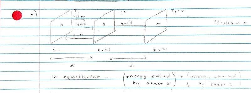

For part b...
I'm using the idea that energy emitted by sheet 2 = energy absorbed by sheet 2
## \sigma_B T_2^4 + \frac {P_{23}} {A} = e_1 \sigma_B T_1^4 + (1 - e_1) \sigma_B T_2^4 ##
## \frac {P_{23}} {A} = e_1 \sigma_B \left( T_1^4 - T_2^4 \right) ##
## P_{23} = A e_1 \sigma_B \left( T_1^4 - T_2^4 \right) ##

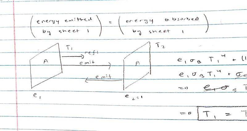

For part c...
I'm using the idea that energy emitted by sheet 1 = energy absorbed by sheet 1
## e_1 \sigma_B T_1^4 + \left( 1 - e_1 \right) \sigma_B T_2^4 = \sigma_B T_2^4 ##
## e_1 \sigma_B T_1^4 = e_1 \sigma_B T_2^4 ##
## T_1 = T_2##
Now this has been bothering me, because if ##T_1 = T_2##, then ##P_{23} = 0##? I can't seem to make sense of that.
baseballfan_ny said:
For part b...
I don't see how you get this equation. Surely emissions from the third sheet are part of the middle sheet's energy balance. And can't you immediately write down how ##P_{23}## depends on ##T_2## without reference to the other sheets?
But ##T_3## = 0, so it doesn't emit any energy, right? I suppose it can absorb energy emitted by ##P_{23}##.
haruspex said:
And can't you immediately write down how P23 depends on T2 without reference to the other sheets?
I had thought that originally ... that ##P_{23} = A\sigma_B T_2^4##, but I think there has to be equilibrium maintained? So that's why applied those conditions.
I just don't think it makes sense for ##P_{23} = 0##.
But T3 = 0
Sorry, I missed that.
That equation is a valid answer whether or not equilibrium is maintained. The answer you gave includes T1, which is not allowed.
Please explain how you get that equation.
One thing I am not clear on is whether you are supposed to assume all arriving energy is absorbed, or whether in each case absorptivity equals emissivity, so (1-e) would be reflected (much complicating matters).
My idea was that the total amount of energy emitted by sheet 1 = total amount of energy "delivered" to sheet 1 (I realized I wrote "absorbed" instead of "delivered" in Post 1 so that was probably confusing). The first term is the energy emitted by sheet 1, since it has absorptivity = emissivity = ##e_1##. The 2nd term was the amount of energy (originating from sheet 2) reflected by sheet 1. The right hand side is the amount of energy delivered to sheet 1 from sheet 2.
I believe I'm supposed to take ##a = e## by Kirchoff's Law.
Ok so I'm getting something new. I think I'm supposed to say sheet 2 emits ##J = \sigma_B T_2^4## and then enforce equilibrium.
So then my answer to part b would just be...
## P_{23} = A \sigma_B T_2^4 ##.
Then for part c I would enforce equilibrium on sheet 2... that however much is absorbed by it is emitted...
##(1 - e_1)\sigma_B T_2^4 + e_1 \sigma_B T_1^4 = \sigma_B T_2^4 ##
where the first term is the amount reflected by sheet 1 and reabsorbed by sheet 2, the second term is the amount emitted by sheet 1 and absorbed by sheet 2, and the right hand side term is the amount emitted by sheet 2.
So...
## \sigma_B T_2^4 - e_1\sigma_B T_2^4 + e_1\sigma_B T_1^4 = \sigma_B T_2^4 ##
##- e_1\sigma_B T_2^4 + e_1\sigma_B T_1^4 = 0 ##
##T_1 = T_2##, but as you pointed out, ##P_{23} = A \sigma_B T_2^4## and should not be in terms of ##T_1## so I no longer have ##P_{23} = 0##
You cannot assume the emissions and absorptions of sheet 1 are in balance. There will surely be a net flow of energy from 1 to 3, even though 2 is at a constant temperature.
If you have to allow for reflections then there are in principle infinitely many.
Create unknowns for the total flow from 1 to 2 and 2 to 1 and write equations relating these to the emissions and absorptions.
